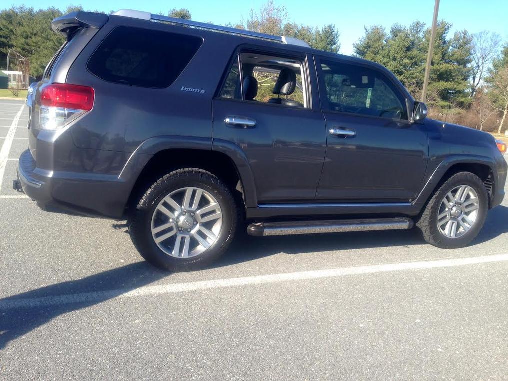

Hello! Purchased an out of state 2012 Limited with 24,000 miles. Felt it wasn't too risky since it was Certified and the AutoNation dealership we purchased it from has excellent reviews and offers a full money back guarantee. It was shipped today, and unfortunately the flashing 4LO light and traction control light was on so we immediately brought it to a Toyota dealer. They were not able to determine what the issue was right away so we left the truck there and hopefully they are giving it a full inspection and can diagnose the issue. Very disappointing!! Does anyone have any idea what this could be? Thanks so much if you can help.
