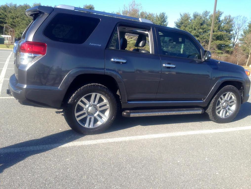

Hello. I posted this in the mechanical section also, but maybe someone here can help. Hope that's ok. I purchased a 2012 Limited with 24,000 miles on it out of state and it was shipped today. I didn't feel it was too risky since it is Certified, and the AutoNation dealership has excellent reviews and offers a full money back guarantee. Unfortunately, the 4LO light was flashing and the traction control light was on so we immediately took it to a Toyota dealer. They could not diagnose the issue right away so we left it there overnight. Hopefully, they will give it a full inspection and determine the issue. Very disappointing though! Does anyone have an idea what this could be? Thanks for your help.

It could be due to some strange way it wa loaded or unloaded from the car carrier. I assume you have it at a Toyota dealer. Make sure you talk to the seller immediately and that they have agreed to cover any expenses. Hope it works out. Could just be a fault code so I guess you'll find out soon enough!
Thanks for your reply! Yes, it is at a Toyota dealership near us. The Toyota dealer that we purchased it said any issue would be covered under warranty, but it still makes me nervous that there would be an issue before I even had a chance to drive it. Plus, I am worried they might blame the shipping company if that's what it turns out to be. I guess we will find out. Was just hoping someone might've had that same issue and was concerned that the service center couldn't have diagnosed it more quickly. Thanks again.
I'm sure it's nothing major. Sounds like the 4wd lever was put in the Lo setting. That would cause the light to flash because it has to be in neutral to engage in Lo and the traction light would also be on.

It seemed to run fine other than the flashing lights. The mechanic mentioned that maybe the rear differential was locked. Just would've thought that they would have found the cause after it was there hour and a half. We ended up having to move it to the dealers other location since the technician opened the door into the lift and put a big scratch on the door. That's another story though. Not a good first day:/ thanks for your help though! I just don't want to have to give the truck back if it's something major.

Turned out that the left rear wheel speed sensor was damaged, therefore the 4wd will not work. $530 repair not covered under warranty. Must've happened during transport, but the transport company is just blaming the driver, which is a different company apparently. What a mess. Exactly one of the scenarios I feared buying long distance like this:(
