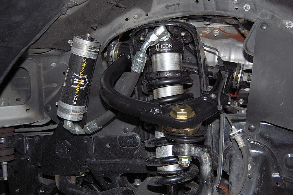

I changed out the Total Chaos UCA's last night for the Light Racing ones without a hitch.
Took about an hour and that was with rotating the tires front to back too. I went back in this morning after doing some test rides and adjusted the caster to a +1 and I originally set it for 0. Also adjusted the camber a smidge to give a wee little Neg camber .Taking it to a frame shop next week to double check the alignment but rides really nice and straight now. I really like how easy they are to adjust and very good quality so far.
I do have the extended travel coilovers and thought the TC's would give more travel with the uniball. I checked the wheel travel by jacking it up so the front wheels were barely off the ground before taking off the wheels with the TC's on. After I changed UCA's to the LR's and when I reinstalled the wheels it was exactly the same.I thought the wheels would have a bigger gap under them with less wheel travel but not so,another case closed for myth busters!

Any thoughts on what is limiting the travel? The UCA or the coilovers? If I don't need the reservoirs, no sense in paying the extra $$$. Nicely done, Harper.

Thanks buddy. I was wondering if uni's really did give you that much more articulation/travel. Good to know...For some reason I really like the fact that LR's are sealed and require so much less maintenance.
Now the true ? is how much more travel are you really getting with the extended travel ICON's??????? Would love to have you and Jesse measure them both up so we could see the difference :)
