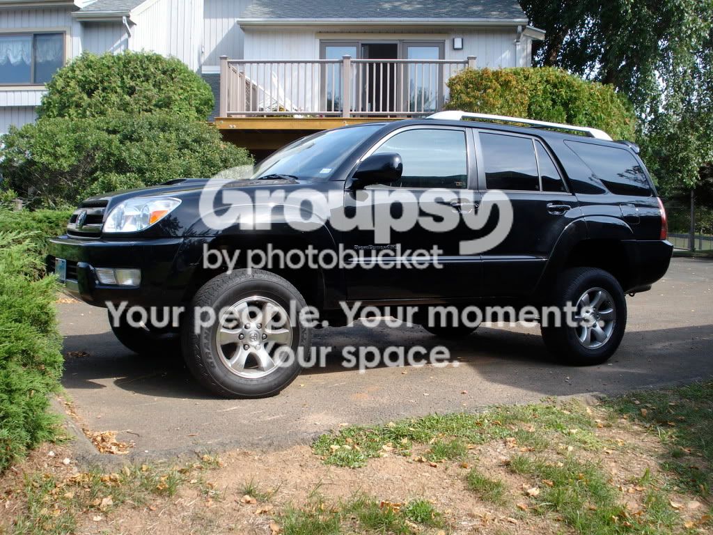

Got the toytec ultimate 3" lift kit on today, went pretty well except for the rust from being a MA vehicle... the rear actually took longer, the drivers side shock mount on top sheared off, and the passenger one we broke off. undercoated everything while we were down there as well. The front was really easy except for the skid plates bolts,3 of them sheared off so next weekend Ill buy some easy outs and replace em. It did help spraying everything down with PB blaster since friday! Ive got a few pics but not the finished product until tomorrow when theres light.

and this is when we got it
