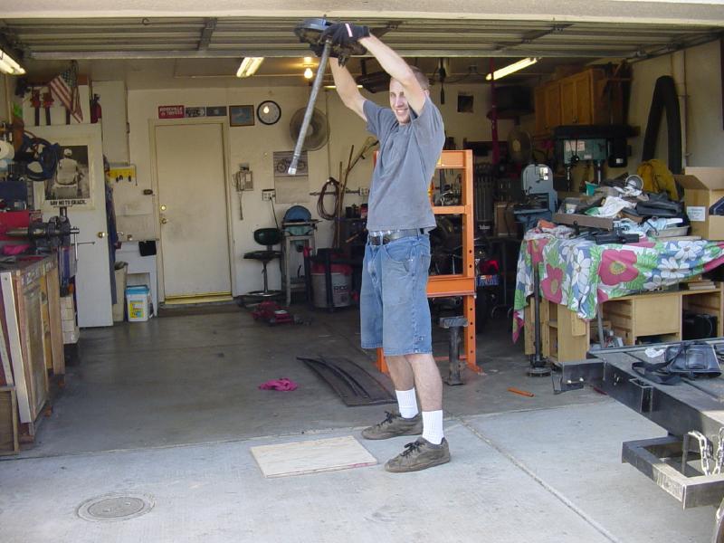

I used the "pound the shaft on a chunk of wood" method to get the backing plate/bearing cups off the axle. Hurts, but works and is cheap
Toyota Maintenance: Replacing Rear Wheel Bearings and Seals
not me but a pic from the above thread
