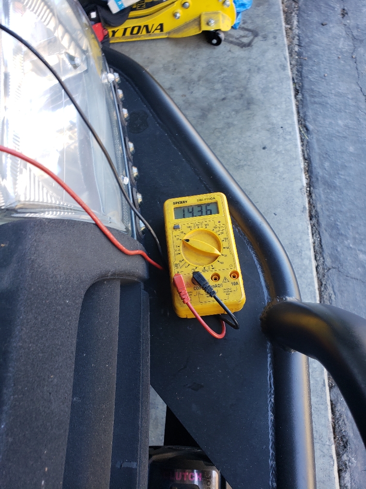

I hookup the VOM, do some tests and it jumps up to 14.5 -.8 everytime I give it gas with lights off. Once I turn on my headlights, give it gas it shoots up to 15.5 and the lights get bright. Wtf! It doesnt do this with my OEM unit.

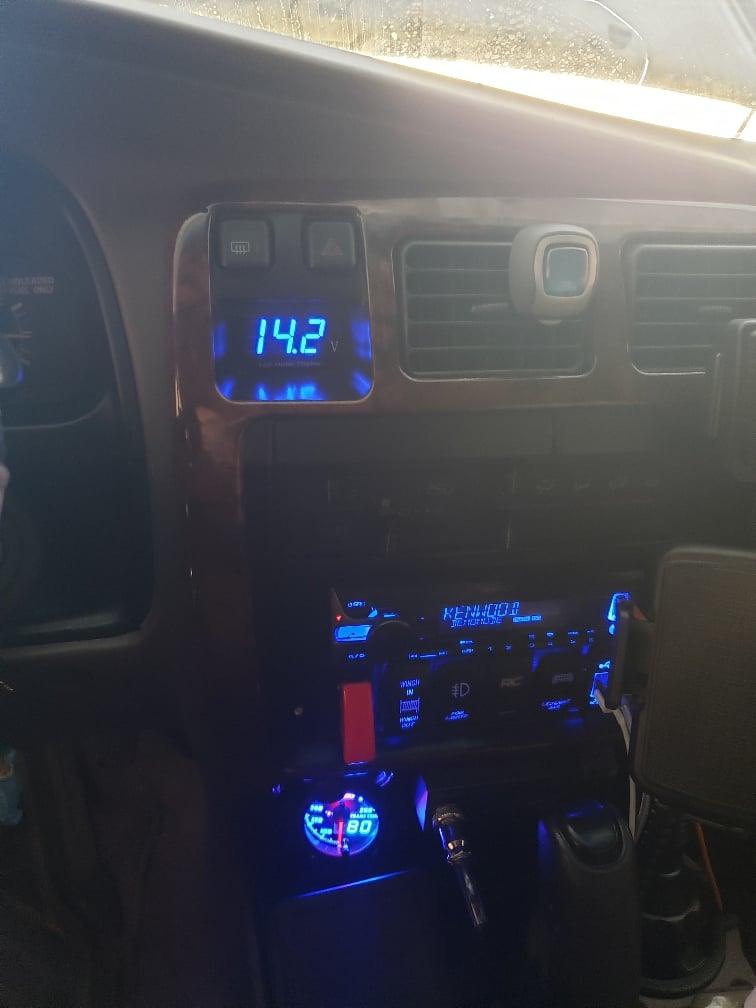

Cold start, my cab volt meter shows 14.2, 14.3 on VOM. It's usually .1 off from my VOM.

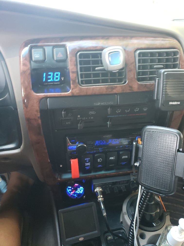

As I'm driving, doesnt matter what rpm or speed, stays at a steady 13.8

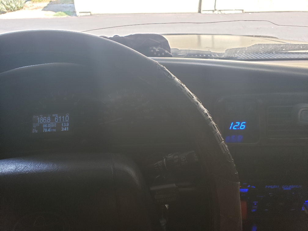

Warmed up in Drive at a stoplight it stays at a 12.6

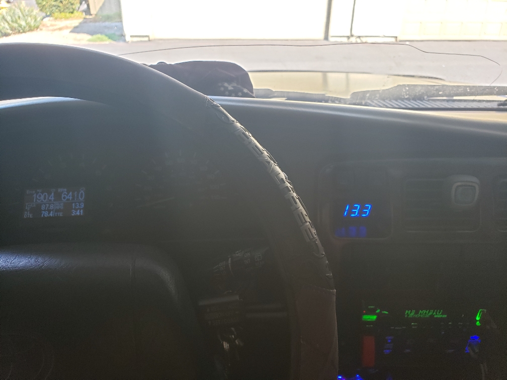

My idle RPM is always around 590-620. Now the weird thing I noticed, is that it seems my idle voltage drops under 640 rpm. At 640-660, my voltage will be 13.3-13.8. I tried to snap a quick picture of my voltage at 640 rpm before it settles around 600.
Either way, with the headlights on, in park idle voltage at 13.8 will still spike up to 15 once I give it throttle and my headlights will brighten. Headlights off, throttle, wont jump past 14.8. OEM Denso back in, no issues whatsoever.

Cold start:
Driving voltage:
Stoplight idle voltage:
Voltage @ 640 RPM:
