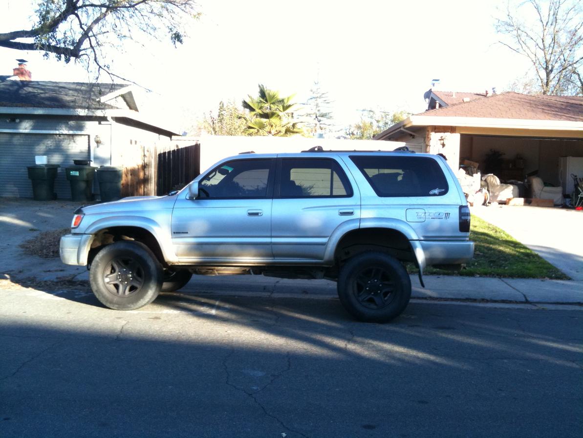

You can do the 7 or 8-wrap of you like a little rake
ya i have 8 and heres what mine looks like with a 3inch spacer...
