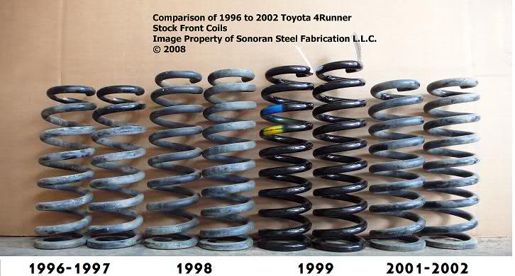

Well I think there's going to be a little bit of a difference because weight is shifted towards one side but it shouldn't be that big of a deal... Your current coils also may have developed some sag possibly. What year is your 4runner? There is definitely a difference in coil heights over the 3rd gen years.

I know you probably did this, but make sure the driver side coil is on the driver side to account for the weight of the gas tank. Check the bushings like idlingmike said because if the old one was bad it could've lowered your car a little bit without you knowing.
You do have pink/blue on driver's side and and blue/yellow on passenger side, right? Because I would think if you put the pink/blue on the passenger side you would get an excess lift on that side.

Well it sounds like your a little taller than the average but not out of the variance. The Toyota's as said do require the proper spring on the correct side. The seat position on the shock as far as the coil end location has nothing to do with height only what slot the retainer is in. I would guess they will settle maybe .5".

Your experience sounds much like mine. I gained 2.75 inches in the front with this same set up. I was 1 inch lower in the rear unloaded all said and done. That's with 99 tall coils all around.
I ended up getting OME 906s to put in the rear and now it sits dead level. I have over 50,000 km on this set up.
I blame the drastic gain in the front on the fact that I have a very light base model 4cyl. 5spd., no A/C, no fat lip bumper, no added weight etc.. Most of the height info you see on here is based heavier trucks as far as I can see. I was not happy to see how much lift I got out of this set up but what can you do??? I'm still trying to find a way to drop the front down 1" but have not figured out how best to do this yet.
