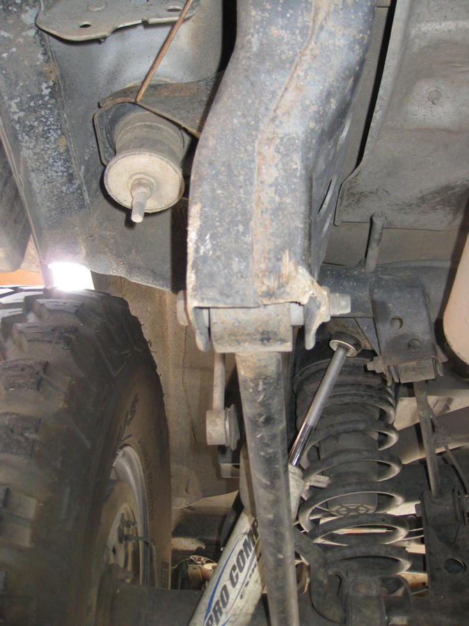

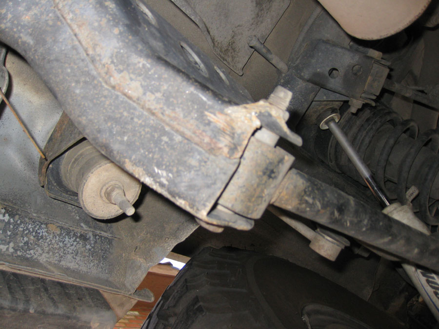

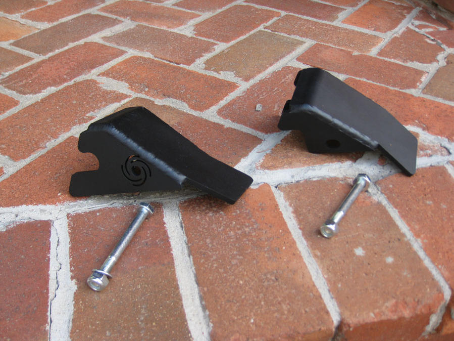

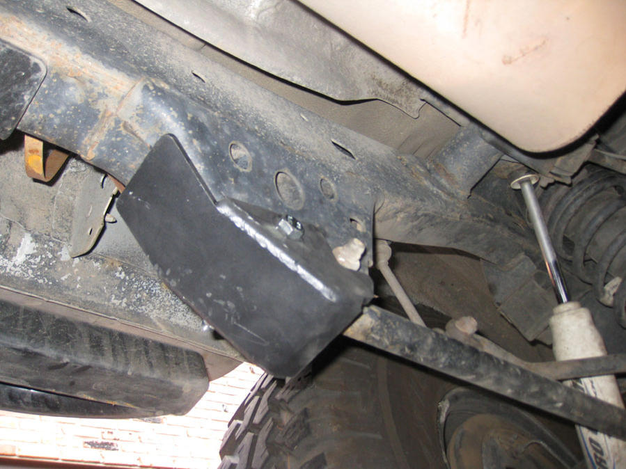

No definitely need a belly skid. I have come very close to my transfercase, and my frame cross member is scratched up to hell. I ordered some rear control arm skids b/c I was deforming them from rocks. If you play in the rock you need the armor.
I must thank Glen at Lotus Development who was super quick on getting me these skids.... I wouldnt want to have to replace the entire mount, mostly b/c I know nothing about welding! LOL
Thanks again Glen!
