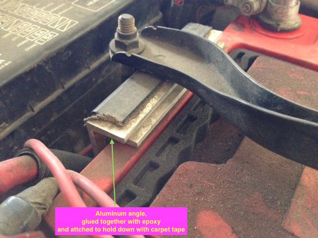

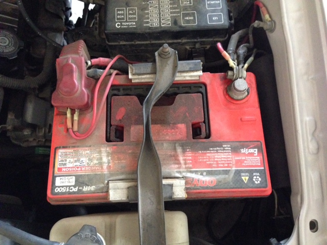

I accommodated the same PC 1500 34R battery similar to the way you did, except instead of cardboard, I added aluminum angle to the stock hold down cradle ears. Glued with epoxy. Dead solid. Still fine, going on 6 years.

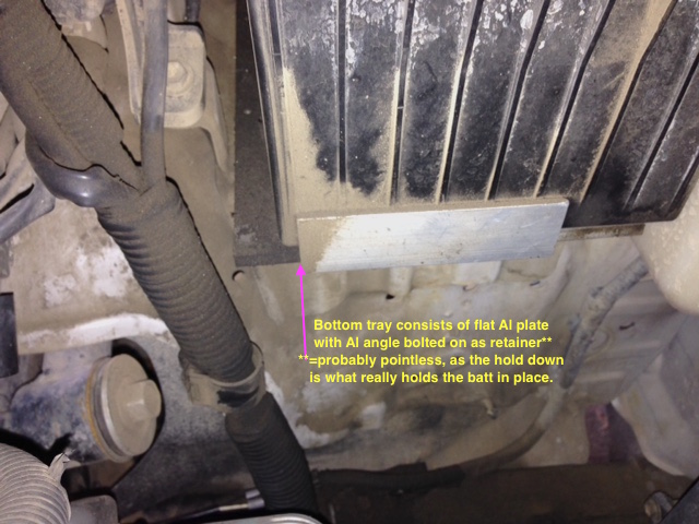

FWIW, here's my adaptation of the stock hold down:

This. No need for a fancy battery holder or spacer. Just make sure the battery is tall enough to contact both sides of the stock tie down and crank it tight.
