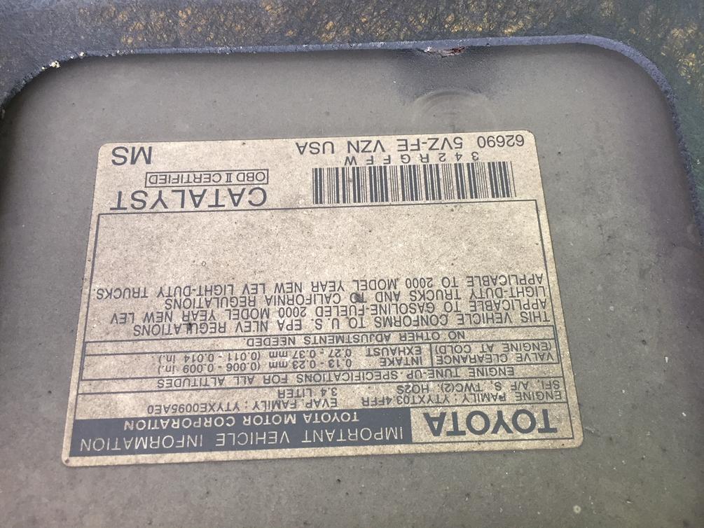

for 2000 4runner limited, should i get california emission or federal emission muffler?
I took a photo from my hood but i don't understand if i should use federal or california. thanks

I've heard that california emission one and federal emission one are different in size?
just by looking at the sticker, it saying it comply with both? then should i use california or federal?
You should use California. The key line is under Engine Family where it says:
SFI, A/F, S , TWC(2), HO2....
That tells you you have TWO catalytic converters and that means a Cali. system. TWC means Three-Way Converter. A/F means Air/Fuel Sensor before the cats, another hallmark of the Cali. configuration. Ignore the rest of the label as it is completely confusing and frequently misleading.
A Fed woud say something like SFI, HO2S(2), TWC
Maryland is one of something like 10 states that the adopted Cali. standard before the feds did but they do not require CARB approved replacements. Any Cali. spec parts will do. I just installed the Walker Cali. muffler and tailpipe. It works, but the fit was funky. The muffler hanger ears were too close together so it rode too high and bumped into the cargo area floor. Had to modify. YMMV.

Wrong. The Cali. muffler IS different, as it has shorter upstream pipe to allow space for the two cats. Only the tailpipe is the same, Cali has different manifolds, crossover, cats, AND muffler.
I think they redesigned the whole thing to prevent people from converting Cali. trucks into Feds to save money on the cats. Otherwise, you would think they could have used the same manifolds.
He lives in Maryland which is one of something like 10 states that adopted the Cali. standard before the feds did but they do not require CARB approved replacements. Any Cali. spec parts will do.
