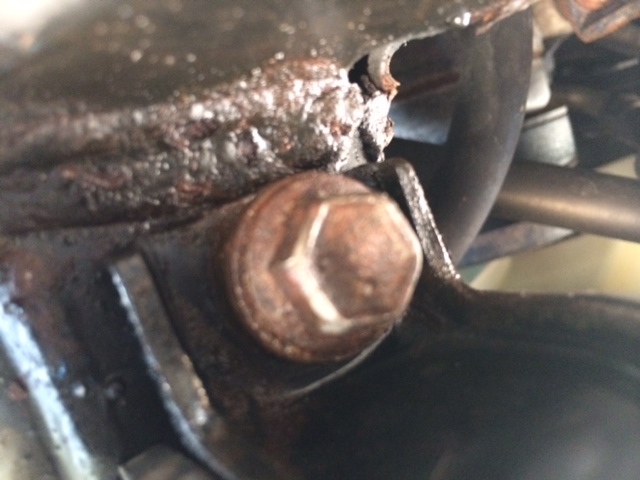

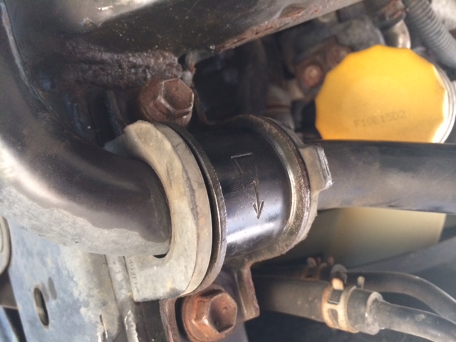

I was attempting to change my sway bar bushings today and one of the bolts snapped and is spinning freely but will not come off. The sway bar bushing mount will not come off either. I've tried prying to bolt off and prying the whole mount on that side off and nothing. So right now, I have one bolt tightened and one that spins freely. I can spin the bolt all day long but it will not tighten or loosen up. Do you all have any ideas what I could do to get that damn bolt off?

The nutsert welded inside the frame probably broke loose . You might have to use a saw or cutting wheel to cut the bolt off. Gettig a new nut inside there will be a challenge though unless there is a cutout in the frame you can reach through. The one that snapped off will need to be cut flush and drilled out. Do you have a lift ? With most lift setups you can just remove the front sway bar. I threw mine out years ago.
Thanks for the responses. I'll go out there in a little and try to cut that bolt off. I don't have a lift yet. I'm planning on upgrading to 5100s and OMEs around but wanted to keep sway bar (to minimize body roll, since I drive with my kid in the truck often).
Thanks for the help again. I was able to get the old bolt out and put a carriage bolt in. Unfortunately, my issue was with the bolt opposite of the one with the open slot. I ended up cutting the old sway bar bushing mount off, then moving the sway bar out of the way so I could cut the old bolt head off. Then some string, a carriage bolt and a coat hanger and I was in business.
