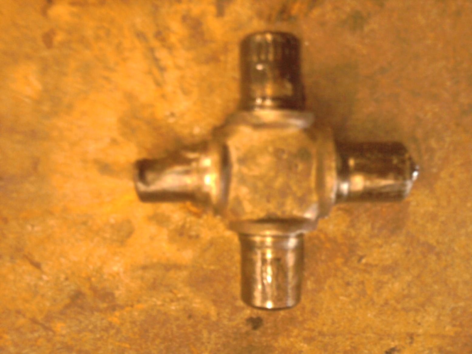

Pleeeeeeeeeeeeease check your U-Joint!!! My '99 Ltd would make a pretty loud obvious "clank" when dropping it into D, and that was the exact problem.
(Sorry the pic is so big, wanted you to see the bent end on the joint -- yikes!)

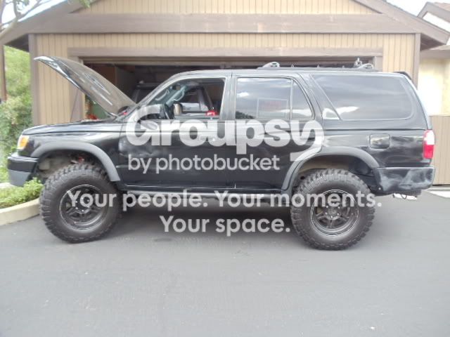

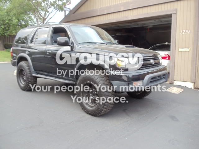

I picked her up today and here are a few pics. Its also on the 3rd gen pic thread.
