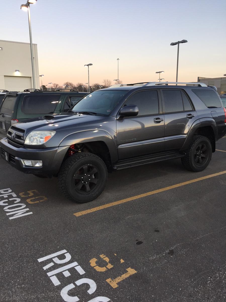

Not sure on your question, but I just installed the ultimate life on my runner a month ago. I got 3 inches of lift the way they came and love the way it looks and rides. I know one of the selling features was you can adjust them on the truck instead of removing them like you will have to with the adjustable shocks. It was a fairly easy diy to install, a big pry bar makes the job a lot easier too. Are you going to get new uca's too? I got the light racing ones with my kit. IMG_0277.jpg

Not sure on your question, but I just installed the ultimate life on my runner a month ago. I love the way it looks and rides. I know one of the selling features was you can adjust them on the truck instead of removing them like you will have to with the adjustable shocks. It was a fairly easy diy to install, a big pry bar makes the job a lot easier too. Are you going to get new uca's too? I got the light racing ones with my kit.View attachment 193933
