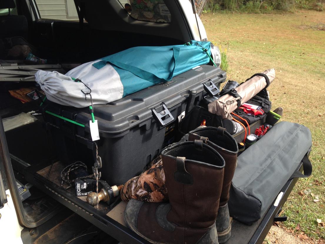

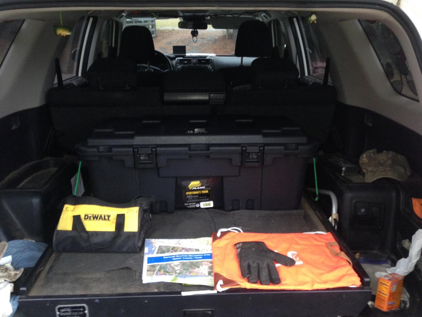

Academy Sports sells a Plano storage trunk that fits across the inside of the 4Runner like it was meant for it. It also has wheels on one end for easy movement when unloaded from the vehicle. There are tie down hooks at each end and I use para-cord to hold mine down to my aftermarket sliding tray. There are even hooks facing the other way so you can tie down a couple camp chairs on top of it with bungees. If stored crosswise it will leave roughy half of your tray available for other storage, or you could use 2 of them. I usually have a cooler and some other gear closer too the rear hatch.

That looks nice and for under $30 you almost can't to wrong. There were no pics of the inside. Is it one big open compartment?

Will the storage locker be compatible with the rear cargo cover? Or does it look like it sits higher than the cargo cover spot on the side

One big open compartment. No dividers or slots for any. I have most of my hard gear in plastic ammo boxes or plastic Sterilite boxes that are stacked in there like Legos. Soft stuff is fitted above ,between, and around the boxes. It measures about 36" long across the top and 33" at the bottom. It's 12" deep on the bottom and 12" high to the lid. If you open the lid to 180 degrees it can be removed. I'm thinking about adding a couple of cable stays to the sides to hold the lid at 120 degrees so I can leave the chair attached without it pulling the lid off the hinges. Mind you it's a $30 trunk. But I've had mine for a year and keeping in mind it's not steel or industrial strength plastic it has held up fine. I would not be willing to use it as a camp seat.

My sliding tray is 5 or so inches higher than the floor, and sitting on that the top of the locker looks like it would be just touching the bottom of a cargo cover (the cover would lay across the top without showing a bulge). I believe the factory cargo tray sits lower but I am not sure.

How much weight do you think you have in the trunk?
I assume the interior boxes are broken down into uses. Stuff like first aid, cooking, tools and so on.

I'm guessing between 50-75 pounds of gear in there. Mostly recovery and tie down stuff That I might actually need in daily use. Some camp clearing tools are scattered around where they fit. It's a stout one man lift but I can still manage it. My cooking gear goes in a tub that is only used for actual trips.
