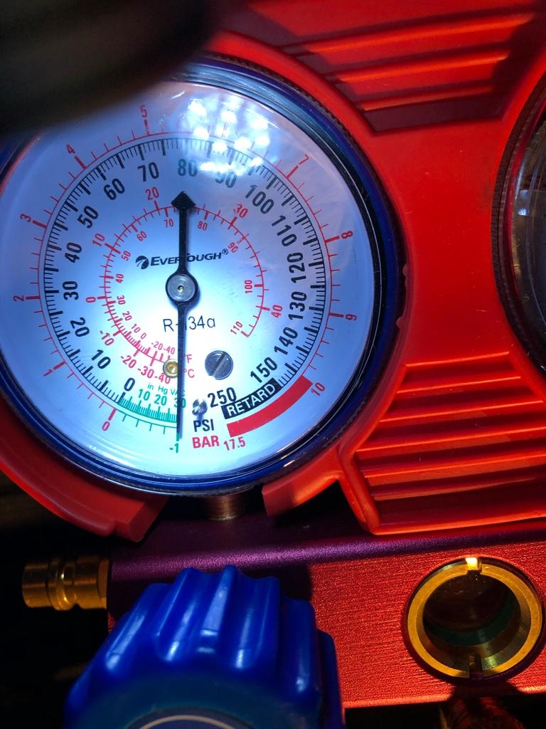

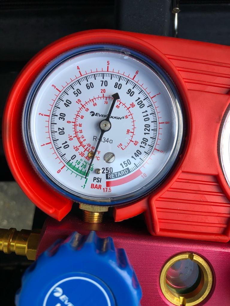

I replaced my evaporator core and condenser last night and pulled a vacuum on the system for an hour then monitored it for an hour and it held fine.
I left the A/C gauges attached overnight and, about 9 hours later, am showing a slight drop in system pressure.
Last night / this am readings:
I’m hoping to button things back up today but am unsure if this is abnormal (ie: A/C gauges naturally lose some pressure via schrader valves, etc.). In hindsight, I should have removed the gauges and rechecked pressure again this am.
Thoughts on this? I cringe at the thought of replacing the evap and condenser again, but would rather do it now if this system is compromised. Thanks in advance

I would be fairly confident that your system is fine and is holding pressure well. Considering all the fittings and hose connections and that manifold gage, there are a lot of little areas/connections for that pressure to slightly leak down.
If you are really worried, maybe adding a bottle of that leak detector dye wouldn't hurt while you replace the R134A refrigerant. This way, if you do have a tiny leak in the future, you can just grab a blacklight and find it pretty easily.
Just my take on it!
The pressure will also change based on the temperature. Higher temp more pressure, lower temp, lower pressure. I dont know how much temp variation occurred over this time. I think you would have had a more significant drop with a significant leak
We probably had a 20 degree swing overnight. This morning I mistakenly disconnected the lines with the valves open, so re-pulled a quick vacuum and monitoring.
Assuming I didn’t damage anything with my disconnection shenanigans and the system holds, I’m leaning towards buttoning it all back up and calling it a day unless someone with more experience than I can definitively say different.
Appreciate the responses guys
