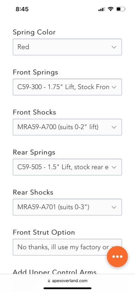

This brings me to Dobinson MRR. Here is the “build” I came up with. Can someone that knows Dobinson stuff confirm this is the build I need to retain the pro height and level the front (I am guessing that means +1 over the already +1 of the pro, effectively +2?)

I had my OEM spring break too, and went with the Dobinson IMS setup. Love it! Went with the c59-300 spring up front (1.75" to 2.0") and c59-599 coil in the rear (1-1.25") which gave me a level look. I think if you did the c59-505 in the rear you would be a little high in the back, if you're wanting a level look? Great setup though, on and off-road. I did go through Mike, at ExitOffroad.com He was great to work with and very knowledgeable.
