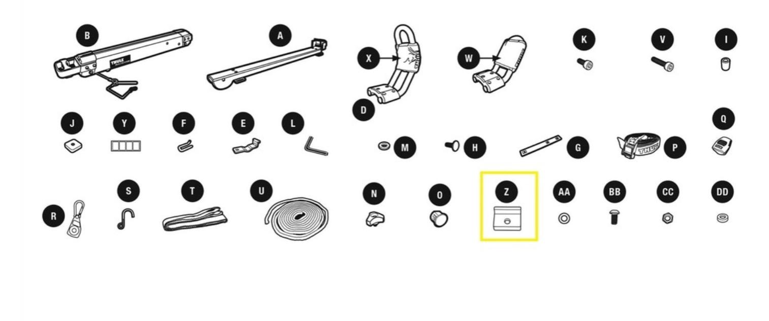

I have mine mounted to Thule aero bars. I had bought them used and replaced the shocks. I had lots of wiggle with mine where they mounted to the bars and also were not level. They worked but not quite right. I purchased the small plastic spacers from Thule and it made things a lot better although the arms are still flimsy once they are deployed.
