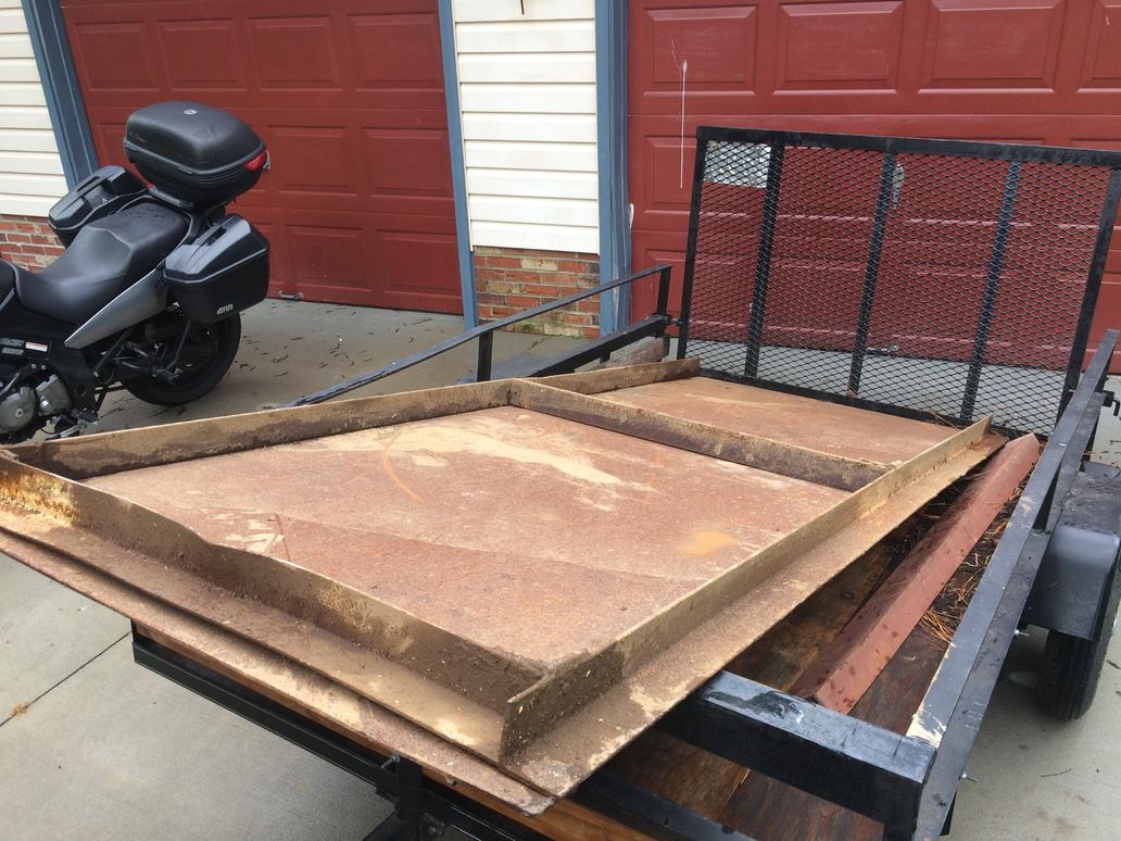

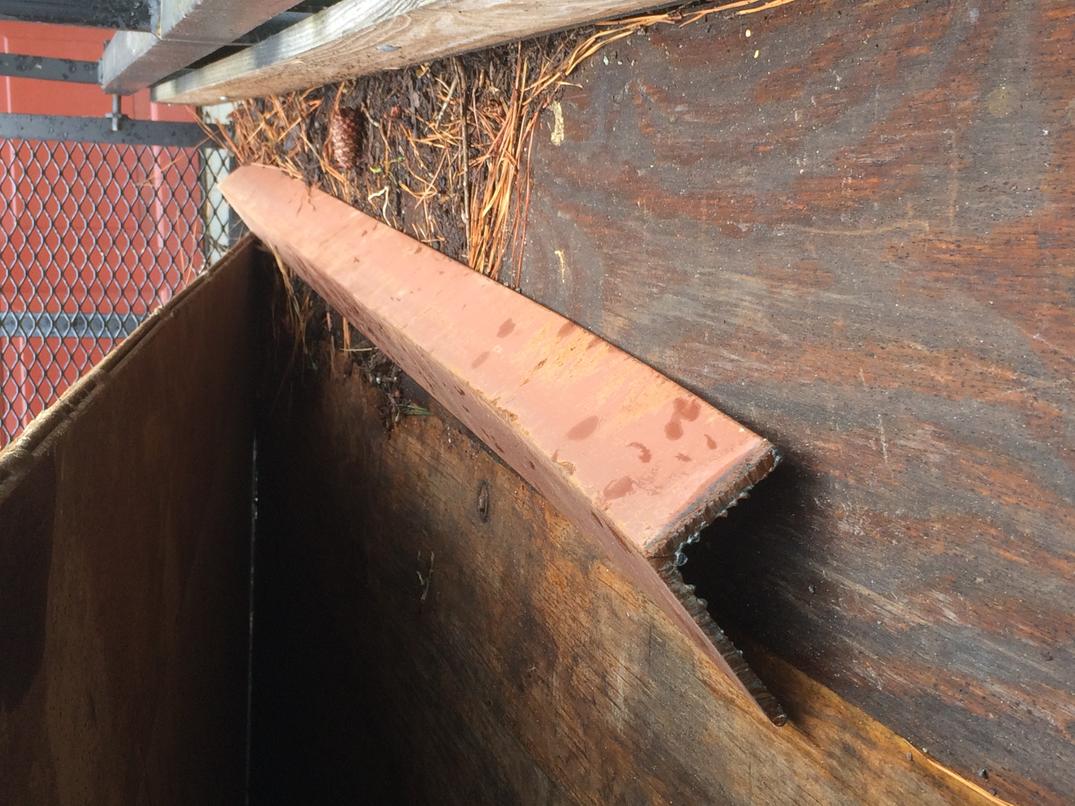

The original sheet I looked at the other day was gone already. All said and done its a 4'x9'6" sheet of 1/4" plate. 25'2" of 3x3x1/4" angle. And a 6' piece of 4x3x1/4 angle. 585 pounds total. Came to 176.49, which is more than I expected, but I guess all the extra angle adds significantly to the weight (~190lbs). I plan to use the 4x3x1/4 to mount up to the frame in the rear, the rest I will cut off and what I don't use, take back for scrap. Rough math says i should be able to get 50 bucks back just for taking the extra angle back. It should be enough, or pretty close to it, to be able to do the front and back bumpers with, but who can say. Anyways

Prepare for some seriously heavy bumpers, if you're going fully 1/4" plate.
FWIW, It took me two sheets of 4x8" to build my front bumper, cutting very conservatively and trying to preserve as much steel as possible. I use 3/16" entirely, even for the winch plate which I then gusseted and braced with 3/8" plate.

Also, how much actually usable steel is on that scrap sheet? Is the angle iron welded on? I don't think I would cut the welds and use the HAZ sections. I'd just cut around it, which leaves you with even less steel :(
