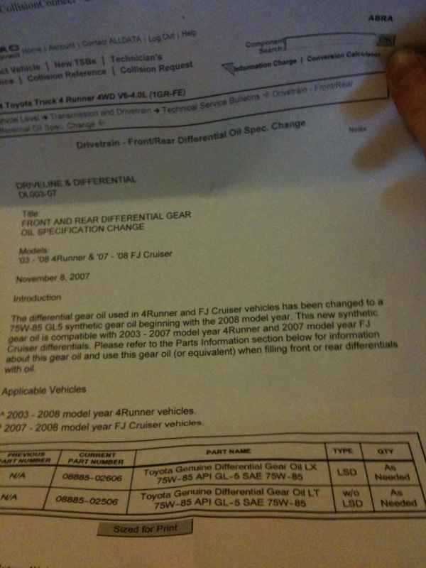

As of November 8 2007 toyota started using synthetic gear oil in all of the 4runners, front, rear and the transfer case! They also said in the same service bulletin that all 4runners 2003-2007 should switch to synthetic at the next service interval! So I would think that if you have the toyota dealer change the fluid they should be putting in synthetic anyway! As long as they know about the service bulletin!
Well I called the dealer and mentioned the service bulletin (DL003-07) and they said only applies to runners with the limited slip which mine doesn't have so on mine they would only put normal oil in.
... toyota started using synthetic gear oil in all of the 4runners, front, rear and the transfer case! They also said in the same service bulletin that all 4runners 2003-2007 should switch to synthetic at the next service interval!...
Did they also change the service interval? What is it for '08+ MY compared to '03-'07, with and/or without towing?
This is what I have, it applies to both trucks with and without LSD`s!
You have a limited-slip center differential.
