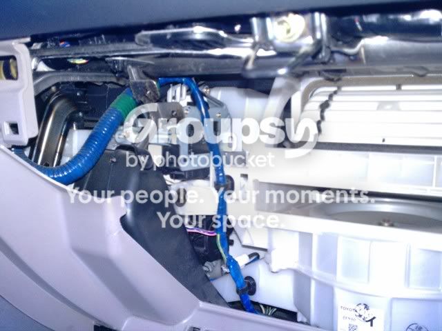

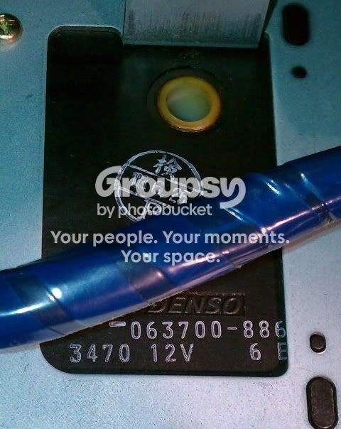

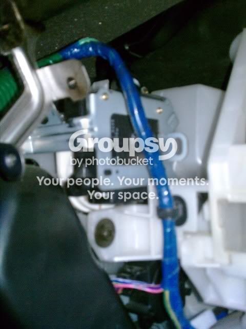

ok here is where the sound is coming from
IMG_20110505_194813-1.jpg~original
IMG_20110505_191504.jpg~original
IMG_20110505_191459.jpg~original
looks like a pita to get too :( anyone with any experience under here lol
it looks like a "Servo mode" or an "air outlet servomode" you think that i can service it? or should i check for obstructions first?
What is the best way about getting to and making sure a piece of paper is not just blocking it?
ok, got it fixed, looks like one of the tabs that open and close the vents jumped out of line, so i had to take it off and put it back like it was supposed to be
PITA! but i have all vents now :)
