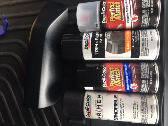

I'm going to paint the roof rails on my 2018 ORP and I'd appreciate opinions on which paint to use. Should I go with the Dupli Color perfect match black for Toyotas or the Dupi Color Trim and Bumper Paint (black)? My plan it to wet sand, prime, base coat, clear coat the rails. A 2012 comment on another thread mentioned using the Trim and Bumper paint as it's designed to flex and avoid fading. However, I would think the fading is more of an issue on plastic parts vs. the metal rails. The flexing may be a fair point. I'm curious if anyone else here has experience painting the rails with either of these products. In lieu of that, I'll just take your opinions.
My plan is to paint only the metal rail, not the caps, which are already black. My logic is that it will be just one more thing to have paint peel on, and it's already black. Now, if once I paint the rails black the color is significantly off from the caps, I might change my mind.

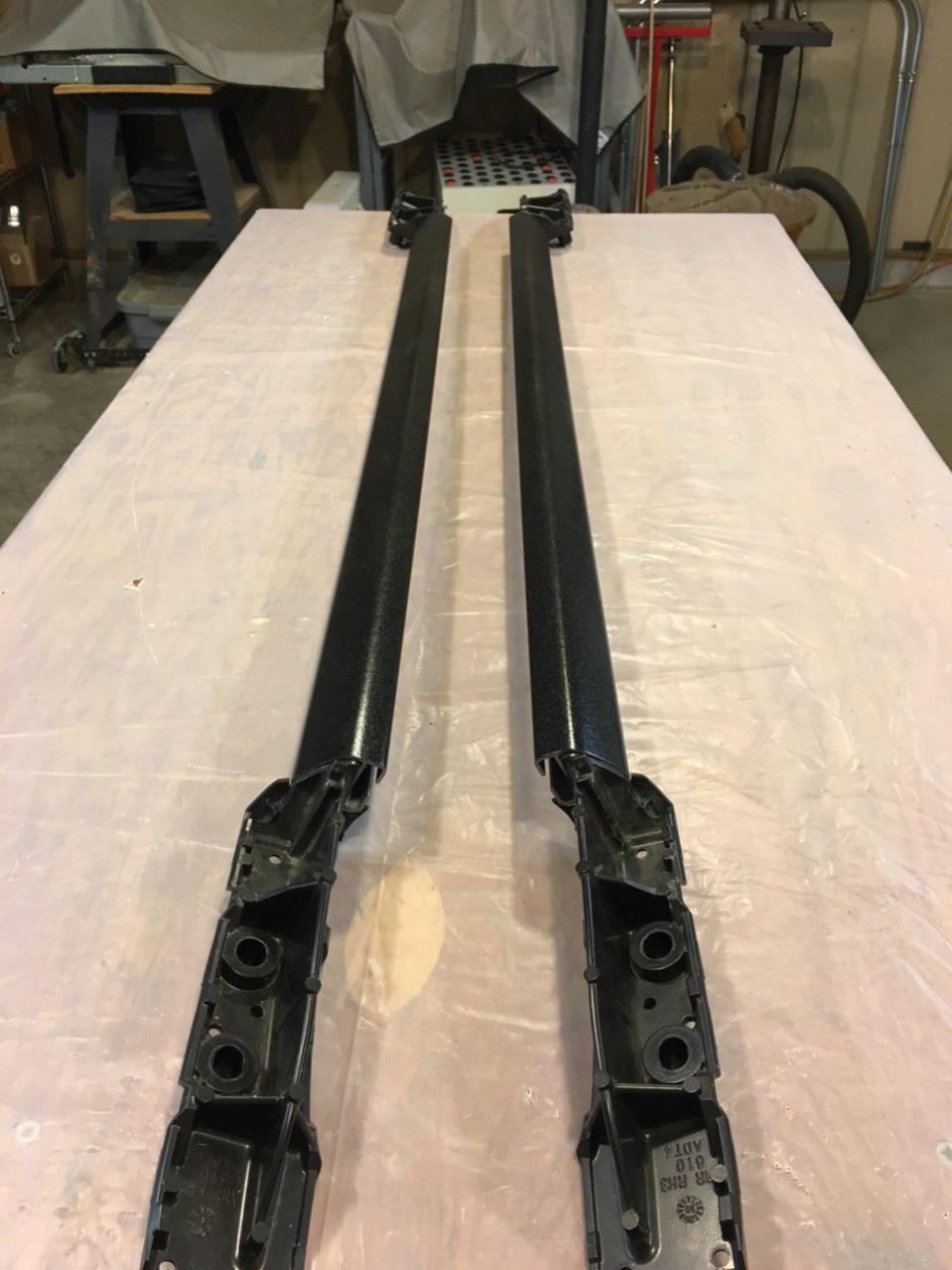

Ended up powder coating
I painted mine using the method you outlined and the paint started chipping off after only a few uses. I had them powder coated and they’ve been perfect ever since. I shopped around and the cheapest I found was $125.
I pulled the trigger on the powder coating and returned all the aerosol paint. I ended up finding a great powder coating place here in St. Louis. They quoted me $125 so I pulled the trigger. They called me today to tell me they were ready to pick up AND that when they quoted me they thought it was a whole roof rack, not just the rails, so the cost would be $25, not $125. The rails look great - I'll post a pick when I get them reinstalled (hopefully this weekend).
Thanks for leading me in the right direction gentlemen.
