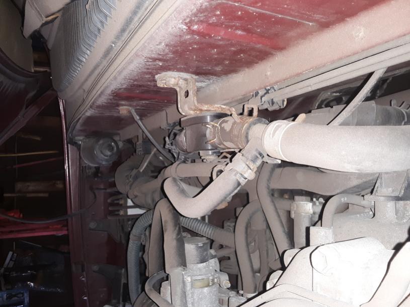

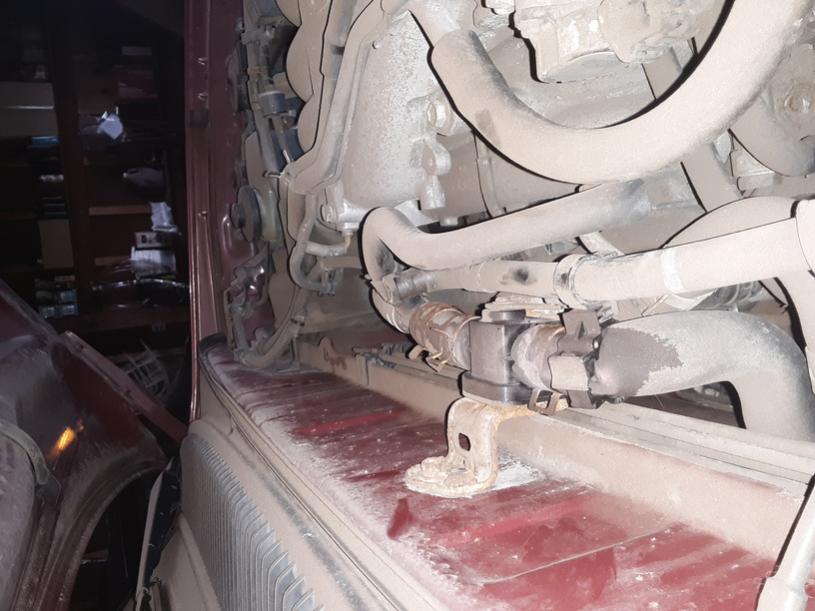

Not much coolant in that rear heater system. Always work on that with engine cold. You can loop the one hose right over to the other and clamp it off. If the heater lines are leaking it will drain itself very quickly. I had a picture on how my 97 is looped.
Sent from my SM-J337V using Tapatalk
