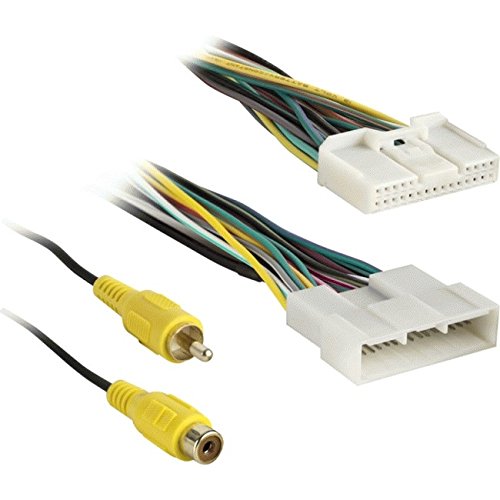

CookieRoe- Sorry to dig up a two-year old thread/question but I'm FINALLY getting around to tackling the VSS/Reverse/parking brake wire tapping project with the goal being to add a backup camera...
First off, the camera I purchased was just a cheap one from Amazon, link provided: https://www.amazon.com/gp/product/B07H852D49/ref=ppx_od_dt_b_asin_title_o00_s00?ie=UTF8&psc=1
The issue that I'm running into is the Yellow RCA cable on the aftermarket camera has nowhere to hookup on the back of the OEM Headunit (E7008). So... after doing some digging and research I purchased this harness but still can't seem to understand how to tap into the Reverse/VSS/brake port... I've found the 5-pin connector housing online but still beating my head against the wall with the hookups.

With all due respect to what you want to do, go another route.
I did the same thing, got the nav unit, oem backup camera, camera tailgate handle, all the extra plugs and wiring, oem Bluetooth speaker overhead console and steering wheel buttons, complete wiring harnesses for camera and amp, radio bezel and hvac unit etc.
There was soooooo much involved that i put all of it away and got a Kenwood unit and camera. It all worked out so much better and less involved, and bonus it has a usb port and bluetooth built in so no trying to get the aux console plug to work.
Good luck if you continue this route.
Any help is appreciated!
Here's the problem: The camera (+,-, etc, etc) wires are part of the 25 pin terminal. You're not going to find any kind of adaptor (say, RCA cable to whatever) that will allow you to "just plug it in". The RCA cable is going to have to be gutted and soldered into regular wires. Of course, you are going to have to figure out what wire does what on the RCA cable. If you are adept at splicing wire and finding how to hook everything up, have at it. As you can see, it's very involved.
Like inscarguy mentioned, if you can , go another route. I decided to go with an Android powered headunit. HiDef camera, Blutooth4, etc etc and it's practically plug and play. If you are headstrong about keeping your OEM NAV (like I was), and you can't do the wiring, find a shop that can help you.
Hope this helps!
Good Luck
