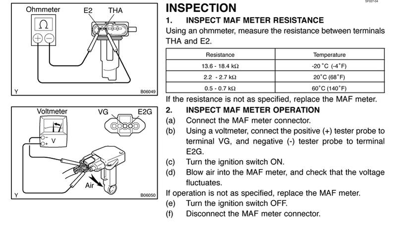

I've been getting the dreaded p0171 code. Since then I've:
Cleaned the MAF sensor... twice (not just the temp lobe either!)
Done the carb cleaner intake check (for the possiblity of a bad seal somewhere)
Changed my plugs with Denso factory plugs
Changed my plug wires
Checked gas cap/oil filler/oil dip-stick for "looseness" etc.
I'm guessing/hoping it's just the MAF. Just bought the rig with 120,000 on the odometer. It has always been a "dirt-road" vehicle until now.
Seems to run fine (but I've only had it for about a month). No studdering or anything.
The CEL usually only comes on when I'm at idle (not while driving) at stop lights and such.
No weird sulfer smells... so I don't think it's the cat (although the second cat will sometimes leak water 30 seconds after start-up)
So... am I correct in assuming I should get a new MAF? Should I go with the ebay kind? Sorry about the length of the post. Thanks. -Nels
