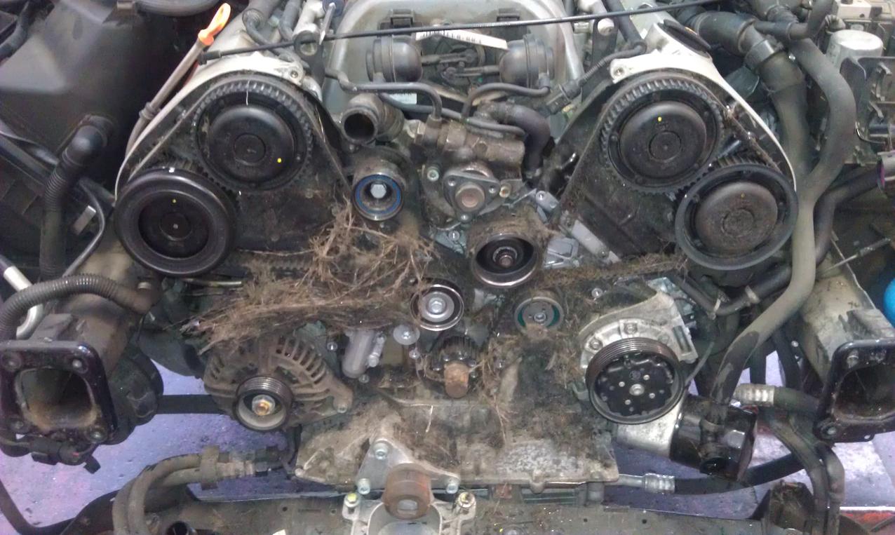

Well it can always be worse. Just for fun here is a pic of one of the timing belts jobs I did a couple weeks ago. The water pump failed and started shredding the timing timing belt, it almost cost them a very expensive engine. It's a 3.0 Audi a6. They were lucky they shut the engine off when it started acting wired and had it towed in. image.jpg

^man that is crazy! making me nervous now.. i need to find a shop around the Longmont, CO area, and get a t-belt & wp put in!
