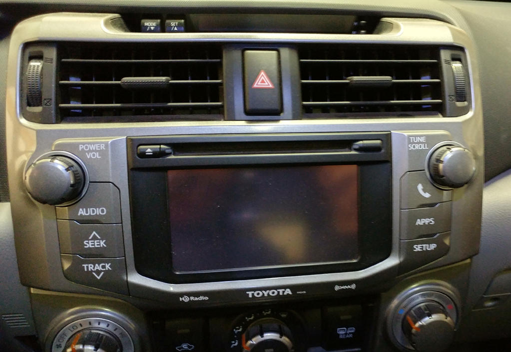

The correct answer is in the CD player slot above the navigation screen.

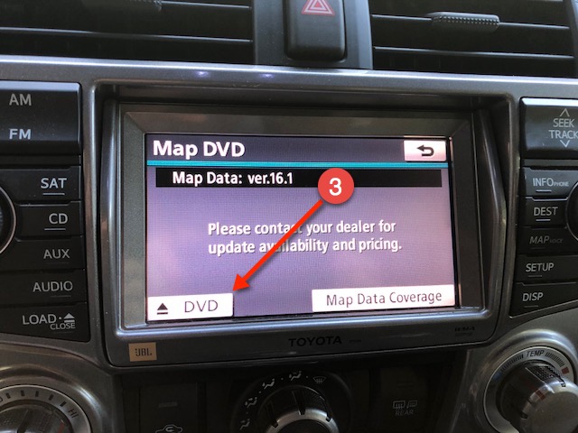

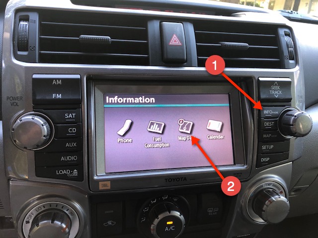

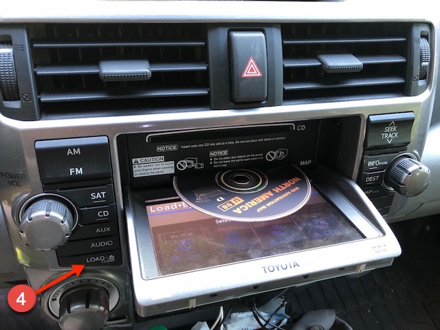

Also, [MENTION=85467]BobsTrail[/MENTION]...That's not quite the right pic for a 2010-2012 Nav unit. The instructions are in the owners manual, the disk actually is inserted behind the nav screen, a series of button presses and the nav screen flips down and the GPS disk will pop out. I go out a snap a couple pics and post them for future reference.
Steps to replace Nav Disk 2010-2012
Here you go......
Don't press step 4 until after you've swapped disks and the new disk has been fully pulled back into the head unit.
