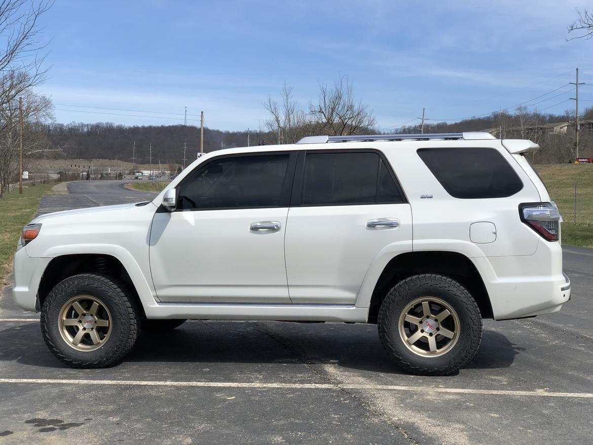

I had that exact kit on my 2013. The front springs are 600# which is stiffer than stock. I had the front struts set at 0, and the spacer installed with the lift springs. Here’s how mine sat with a BudBuilt hidden winch mount and Engo SR10 synthetic winch (about 90 lbs total).
I think if you set the front at .85” you might run the risk of having negative rake, based on how mine sat.
