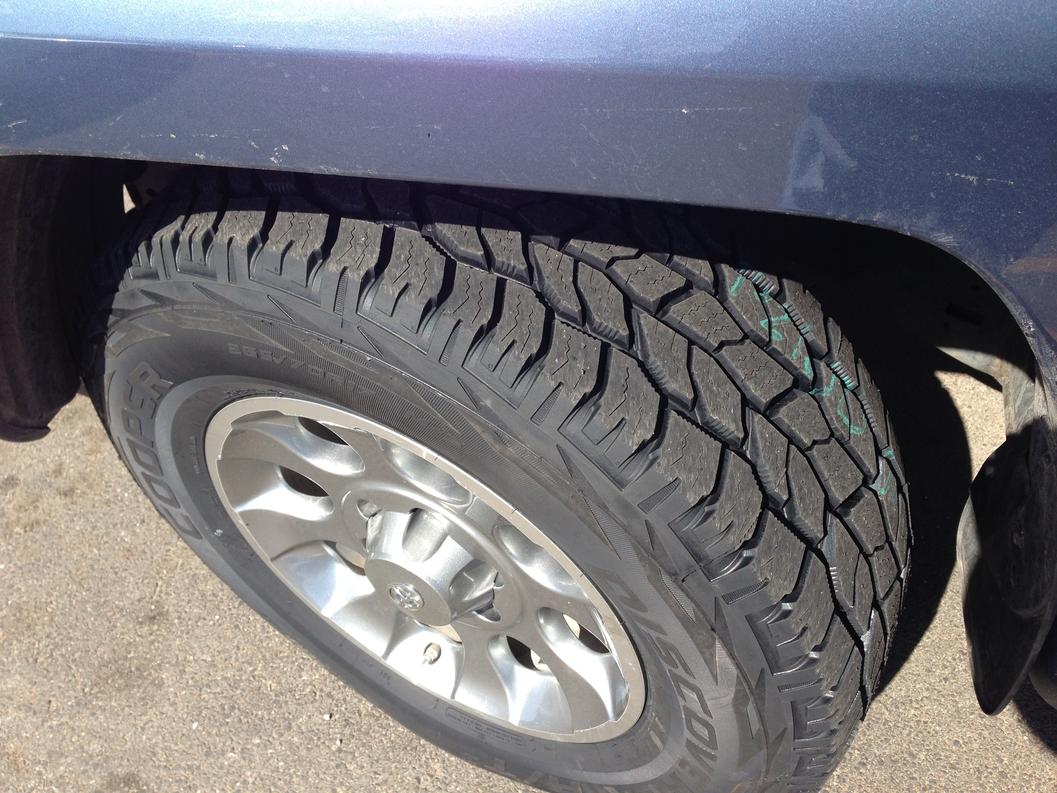

I have the Cooper AT3 and love them. 265 70/R17. Stock, no lift, no trimming etc. Aggressive looks, very low noise. Excellent hydropaining resistance. I have not been off road on anything more than a dirt road but they should perform as well as most all terain tires.

^^^^ See how the Cooper has all those open channels? That's what you want. You want water, snow, mud, etc. to be able to evacuate the tread. This is why the BFG is the most over-rated AT tire on the planet. It looks super aggressive, but functionally it's a horrible tire. It's 35 year old technology. I've owned 2 or 3 sets of BFGs and it's unlikely I'll ever run them again. They are miserable in mud and snow, have high rolling resistance, and can be noisy too because of the interlocked tread pattern. The Coopers, on the other hand, have lots of open channels and will excel at anything you point them toward.
Look for a tire that has a similar type of tread pattern, there are a few others that are pretty good too. But I think the Cooper AT3 is going to be my next tire. If so, I will get the LT "C" version for it's deeper tread.
