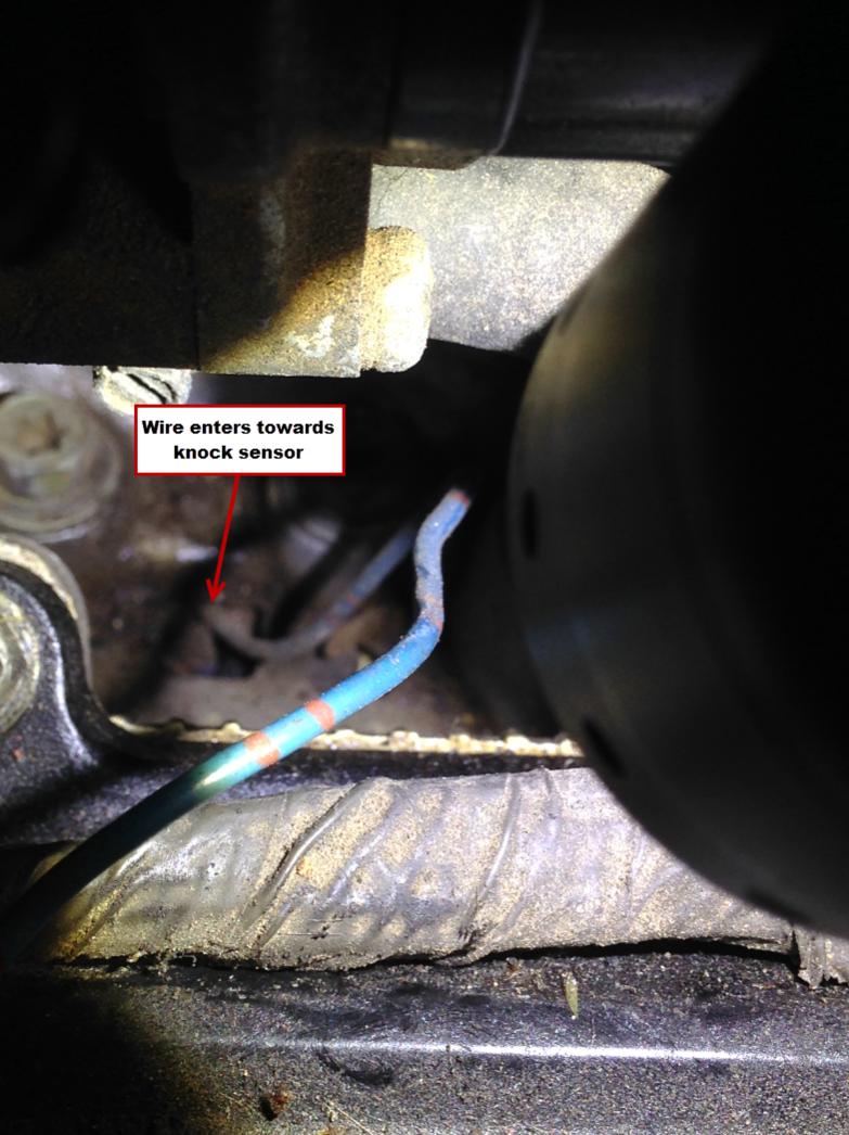

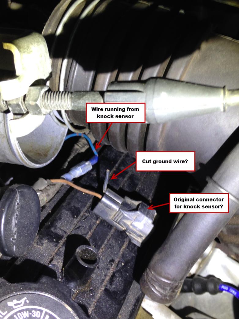

So per the thread I linked in my previous post I decided to look at the connector which attaches to the knock sensor's pigtail and then runs all the way to the ECM. Hoping that a short somewhere on this side would save me from having to replace the knock sensor/pigtail. I found something pretty interesting.
It seems that when the head gasket job was done (by the PO) something was done to the knock sensors wiring. As you can see in the photos the connector which should be plugged to the end of the knock sensors pigtail has been disconnected and the ground wire has been cut. There is now a bluewire leading out of where the pigtail should be.
Someone correct me if I am wrong, but shouldn't there be a ground wire running to the sensor as well? Is it possible they ran the ground wire out elsewhere or simply grounded it near the sensor? Looking for any advice I can get since this is going to make replacing the knock sensor/pigtail more difficult.

I "believe" the knock sensor wiring is as follows:
- A shielded cable between the ECU and the knock sensor connection.
- Another shielded cable (often called the "pigtail") between the connector and the knock sensor itself.
- The shields should connect together at the connector, so I think the cut wire you have is wrong.
- The shield should not be connected at the knock sensor.
- The sensor signal ground is through the block.
It's a quite noisy environment, so if the shielding is not properly connected the ECU won't get a useable signal from the KS and it will throw a code 52.

[MENTION=134884]RonJR[/MENTION] based on what I see in the FSM and my searches I would agree with you. However, the confusing part to me is why there are two wires in the connector which links to the pigtail. If the sensor is always ground through the block then why the two prong connector? In fact I have found several threads stating that there are two wires run to the knock sensors on the 3vze where as the 22RE only has a single wire and is ground through the block. Could it be that they installed an older version knock sensor and assumed it would ground properly through the block?
I have looked a variety of pigtails for the 3VZE through an assortment of years and all of them have two wires suggesting they are grounded elsewhere and not on the block by the sensors threads.
Finally, you state that the cut wire I have is wrong. Do you mean to say it should not be there or that the way whoever did this did so incorrectly? Basically are you saying that they did not shield the wire from where the pigtail should be to where it should connect with the cable from the ECU?
BTW I completely agree with you about the knock sensor (if only due to its location).
The second pin in the connector is to carry the shield through from the ECU wiring to the shield on the pigtail. Since the pigtail shield is floating at the knock sensor, its only connection point is at the intermediate connector. If that connection is also broken, the pigtail shield is left completely floating, which renders the shield ineffective.

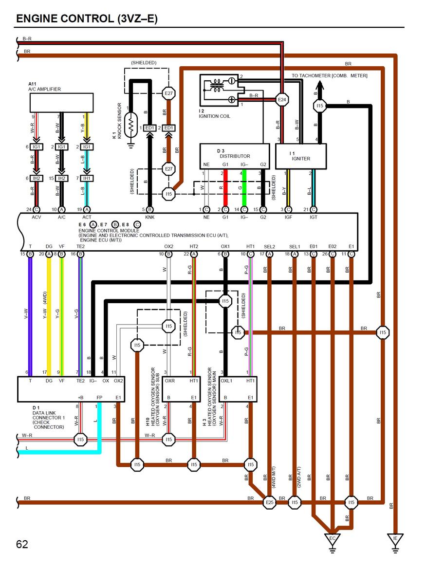

I've attached a colored wiring diagram of the ECU wiring related to the knock sensor which might be helpful. ED1 (top center-left of diagram) is the intermediate connector that carries the signal wire and the shield to the pigtail.

So based on what you have explained here it looks like in my situation the wire is not being shielded properly. This lack of shielding is probably leading to the ECU not being able to detect the knock sensor readings due to noise which results in the Code 52 error code. This means I am probably not going to be able to avoid pulling everything off to get to the rest of the wiring...
As I see it I have two options both of which require pulling everything off.
1) Replace knock sensor with new stock pigtail and rewire the existing two pin intermediate connector with a properly shielded cable and run this all the way back to the ECU. Then connect the intermediate connector and the pigtail in the manner it was made stock.
2) Replace knock sensor and utilize properly shielded cable in place of the current blue cable. This would eliminate the electrical noise component and might be the easier solution for me. I would only have one cable between the ECU and the knock sensor.
What is your opinion of the above? Would both work?
Electrically your two solutions should be equivalent, so either one should work. I think the reason Toyota split the two cables at the connector is they expected the pigtail, which is in a fairly harsh environment, to fail more often. With the connector you only have to replace that part (which is still a big job), but you don't have to get into the wiring back through the firewall and dash to the ECU. Also, the pigtail lives in a fairly high temperature environment, so it needs to be able to survive that. The rest of the cable doesn't have to be quite as rugged.
But as long as you're into both areas, yes, a single cable should work as long as it can handle the temperature all the way to the knock sensor.
And, as the wiring diagram shows, the shield should be grounded at the ECU, and at that point only. (point EC).
