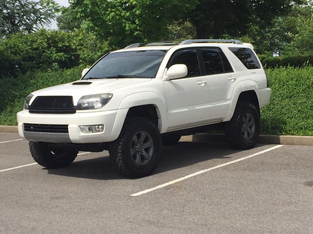

I have taken mine off the times that I have done it. But after the dip I then use spray paint and get the color or colors that I want. Have done three different colors but always come back to the Grey!
