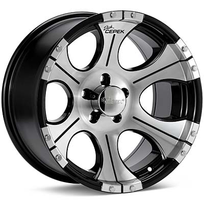

i have a question about wheels that's listed on the tirerack. i want to get this 20inch d i c k Cepek DC-1.
and according to tirerack the offset is -13mm. so my question is if i were to get this rim would i have any rubbing issue with the 265/50 tires?? o and by the way my suspension is bone stock so NO lift :p
pic below:
I'm hesitant to answer as you wanted 'expert advice'. I'm not a wheel guy but I have a clue. The pictured wheel only has 5lugs, that's not going to work:lmao:
-13mm offset is good. T4R's come w/-30mm. Many buy rims w/0mm offset and many like the FJCruiser rims w/-15mm. That means -13mm is squarely in the range. How wide are you looking at, 8"?Those rims are hubcentric, right?
i don't know why tirerack only have a picture of that wheel with 5lugs but it says it also comes with 6lugs. i am looking into getting the 20x9 and i would much like it when the wheels sticking outwards sitting flush with the fenders like having spacers installed. and i wasn't sure that -13mm offset would move the wheel outward or inward.
It'll move the wheel out compared with stock. At 9" wide '0' offset might be a better choice to insure adeqaute UCA (upper control arm) clearance. I don't know for sure though. I do know many who buy 9" wide go for the 4.5backspace. What's the backspace listed as?
