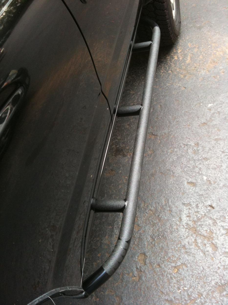

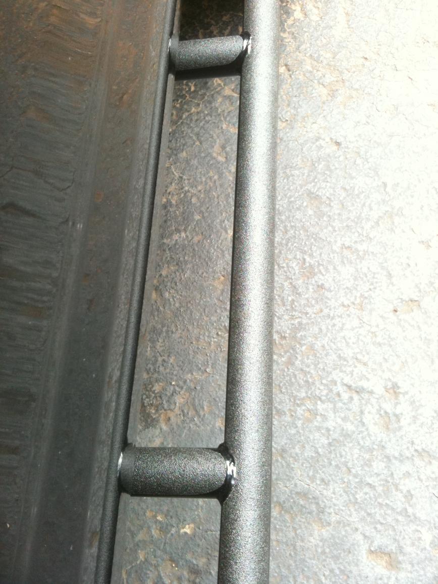

As for the paint do it yourself , get some denatured alcohol and scrub the sliders well to remove the shipping grease, then sand them just scruff them up good, then go over them again with the denatured alcohol.
Use the Rust-Oleum Professional High Performance enamel
I think I used 3 cans of Primer and 3 cans of Black if I remember right to paint both sliders so that's about $40, denatured alcohol was about $5.
Put at least 3-4 very thin coats of primer, then 3-4 thin coats of Black.
Then buy some non skid tape and tape the tops I think that was about $10.
So for under $60 it looks good and probably last just as long as anything else you will find for 4 plus times the price.
except for one single chip on the drivers side caused by a rock mine still looks like the day I did them well over a year ago.
