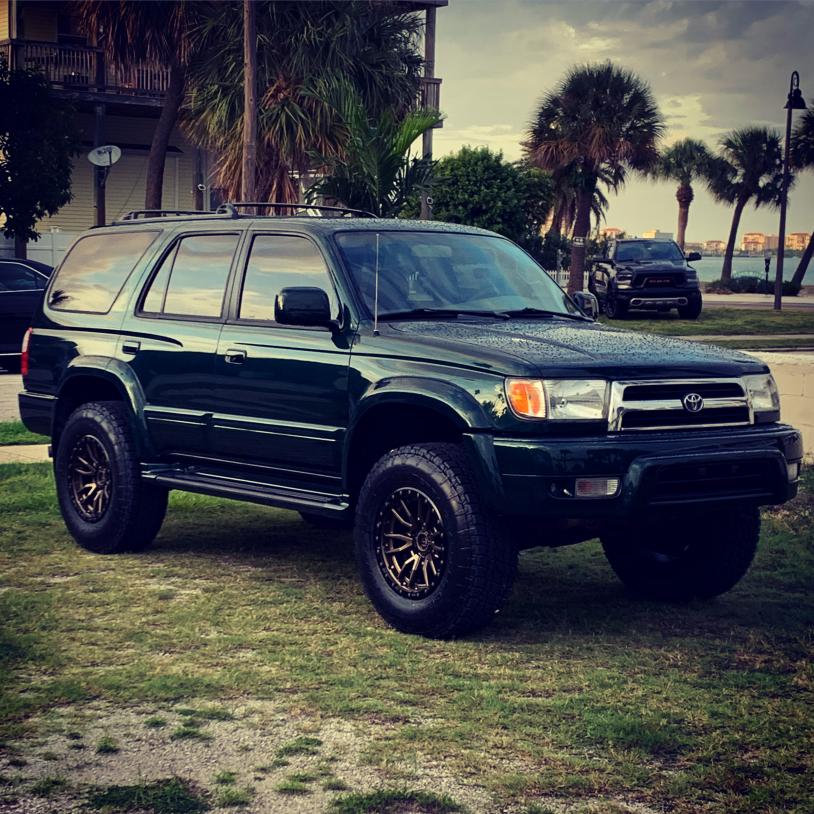

Gen3 1999 4runner
My Gen 3 1999 Toyota 4Runner. You have a nice collection.

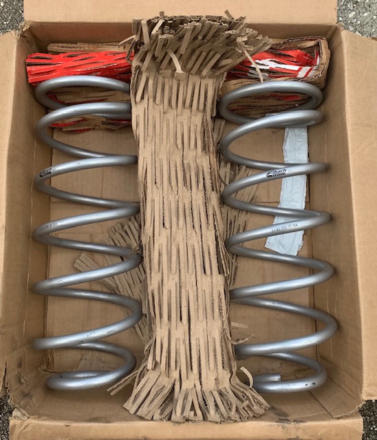

Would anyone be interested in 1 inch rear spring lift by Eibach Pro performance?
For sale, brand new, never used. Fits Gen2 and Gen 3 4runner’s
$125
