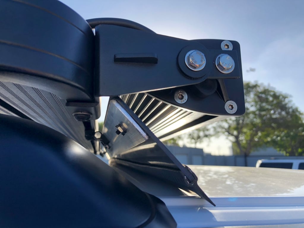

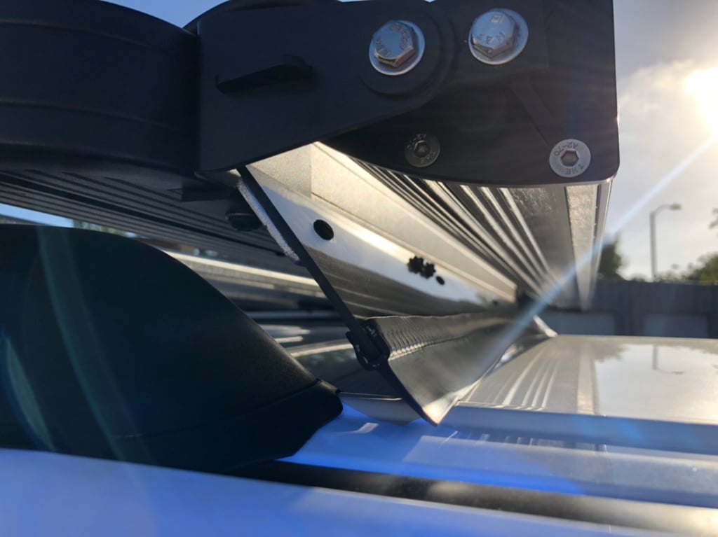

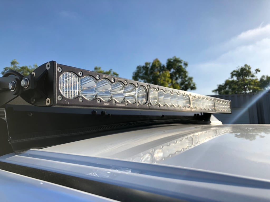

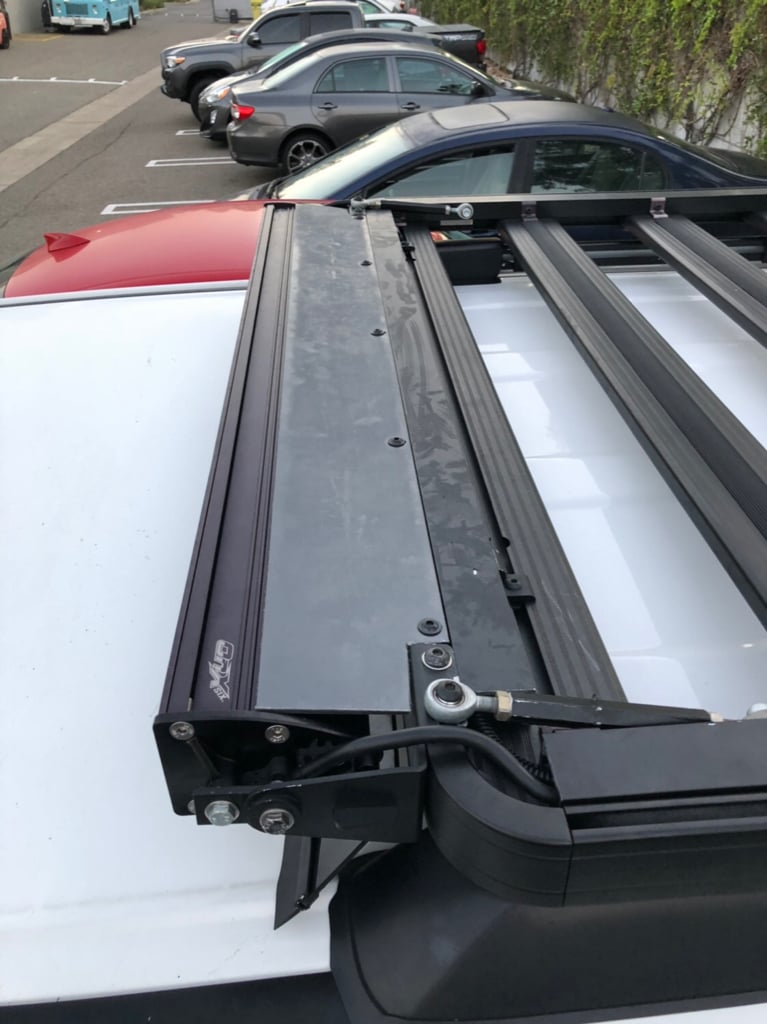

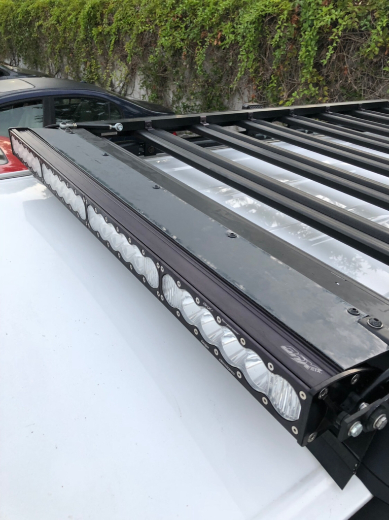

So I've been trying to reduce the amount of wind noise coming from the rack/light bar. I am stumped at this point. I made a wind fairing to close up the gap between the roof and the rack, it has helped a lot under 65mph, anything over that there is no change.
I've tried using the included Front Runner fairing with no luck. I have a feeling a lot of the noise is coming from the light bar, or the air now being pushed up between the light bar and the roof rack.(Next test is to remove the light bar) But I wanted to get some input as to what I might be doing wrong, or anything I can try next.
The fairing I made is using 1/8" Delrin with a rubber edge seal backed by a 1/8" Aluminum Strip for rigidity mounted using friction hinges.
Sorry to hear about the noise. I'd recommend spacing the air dam forward so its flush with the light bar and not the rack. Currently there is a lot of air being forced into the cooling fins on the light bar. At certain speeds this can cause a very distracting noise. Having the air dam forward will allow the air to go over the light and not get forced into the cooling fins.

Yup it's definitely that big honkin light bar. Either move it to your grill or figure out a way for the fairing to incorporate the bar. Also it seems like your light will only illuminate things that are 6 feet or higher, is that useful?
Stick a pool noodle or foam pipe insulation under the light bar. Drive it again and see if that eliminates the noise.

This was my thought as well, there's a huge gap where air is getting through and causing sound issues

That's what I was thinking as well, appreciate the input. I was considering moving the light bar onto the rack which would essentially make it flushing with the fairing. Just to be clear, I am not blaming the light bar for the noise. It's a problem with the way I have it mounted. It's a Jeff problem.

Like BajaDesigns said, the air is getting compressed between the roof and the light bar and the sound I am hearing is the air going across the cooling fins then up into the gap you mentioned. Makes perfect sense.

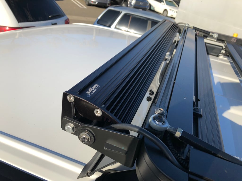

When I had my lightbar mounted like yours on my full length FR Rack it made a ton of noise. I ended up using the other mounts and mounting it underneath with one of FR's channel strips inbetween the light and the rack. I barely hear any noise from it.

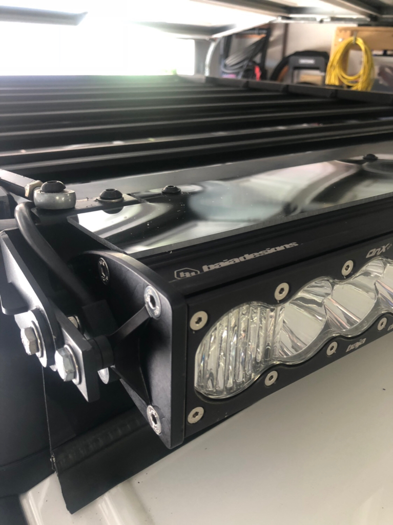

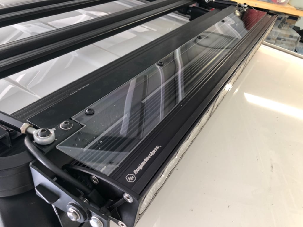

Wow. It’s nearly gone. I used this piece of nylon to test/mock up and it works! Appreciate the help.
