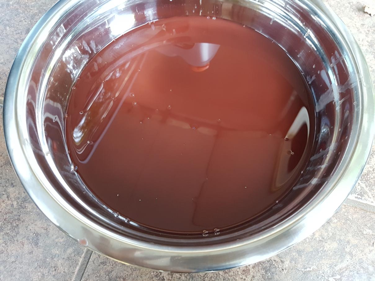

My rad overflowed from the filler tank today ..... Yeeaaaaahhhh.
Levels were fine temp was ok. when parked it and came back out, most of my rad fluid was on the ground. I let it cool emptied the remaining fluid ran it again to see where the leak was. turned out from the filler tank, When I ran it it was backing up before it was over heated. The fluid looked like this , see below,
What does this mean where do I start

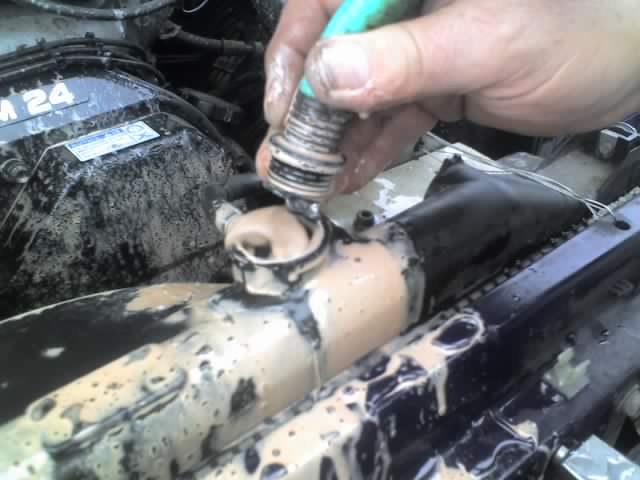

Check your trans fluid before panicking.
I'm not familiar enough with the red antifreeze to know what it normally looks like but it doesn't look all frothed up like pink meringue
That looks like Toyota red coolant. If it mixes it's a lot lighter pink.

Ok so i checked my tranmission fluid and yes it was milky more white but not as white as the second picture above(looks like it was heading that way).
The good:
When this happened I happen to be stopping and parked the car, by complete shit luck. So the milkshake may have gone through the transmission a max of 2 minutes.
My engine Oil was still the same color.
Problems that need to be resolved:
What caused the overflow i have zero idea. My guess is the pressurized transmission cooler inside the rad must have leaked and caused it to over flow or the thermostat must have gotten stuck at the exact same time.
What my plan is:
I'm going install the tranny cooler i just got, again good luck(i hope)
I'm going to flush the rad and flush the tranny until the fluids are good. From that point change the thermostat do a compression test to see about the head gasket.
any other suggestions ??? or thoughts?

That just looks like used Toyota Red to me. But yes, check your tranny's dip stick.
