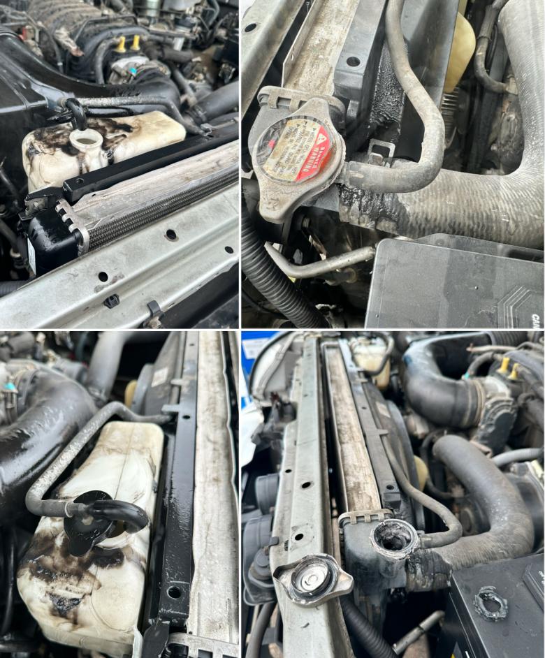

2006 4runner v8 230k on the vehicle.
Timing belt and water pump up to date.
Radiator is two years old. Denso.
Fresh oil change two weeks ago.
On a 100 mile trip the over flow started steaming.
Car engine temp was normal but allllll the lights on the dash came on.
Pulled off freeway to a gas station and popped hood.
Overflow bottle cap was off and gook all over bottle. Let it cool for a bit and opened radiator cap that had all but fell off.
Oil looks fine. Oil cap looks fine.
What says the audience?

You can see though that the coolant was hot enough to start melting black plastic. Tried uploading a picture but it keeps failing
