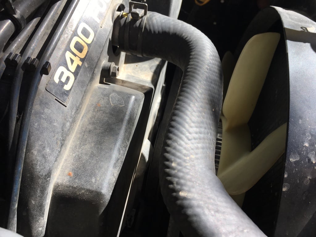

An odd update; I popped my hood and saw that now coolant has leaked from the upper radiator hose where it connects to the engine. Wtf?
What am I missing here? Guessing I have to disconnect the hose and clean up the mating surface?
I still haven't replaced the radiator cap, but I haven't been driving it at all either. The hose is brand new and the clamp is the original clamp with 230k on it. It wasn't leaking before I noticed all of this flat hose thing and I was driving it a bit.

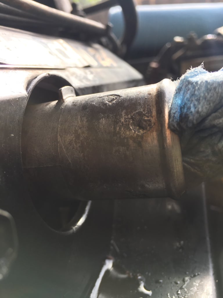

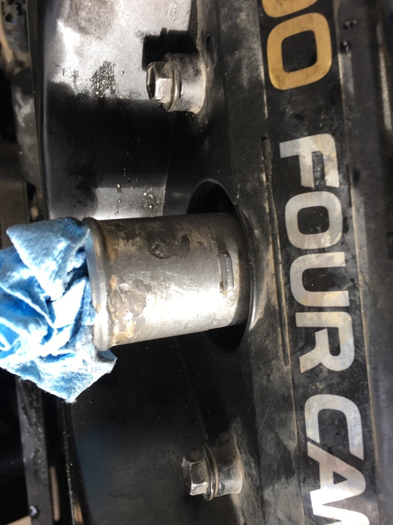

Well, Im making a fantastic mess today forgetting exactly how much coolant comes out when you go to pull the upper hose off.
I bought new OEM clamps for the upper hose. I pulled the hose off and scrubbed the connector quite a bit with steel wool since there was corrosion going on. Picture attached of after clean up.
I also compared a new rad cap with my few month old rad cap and the spring feels the same, so I didn't replace that.

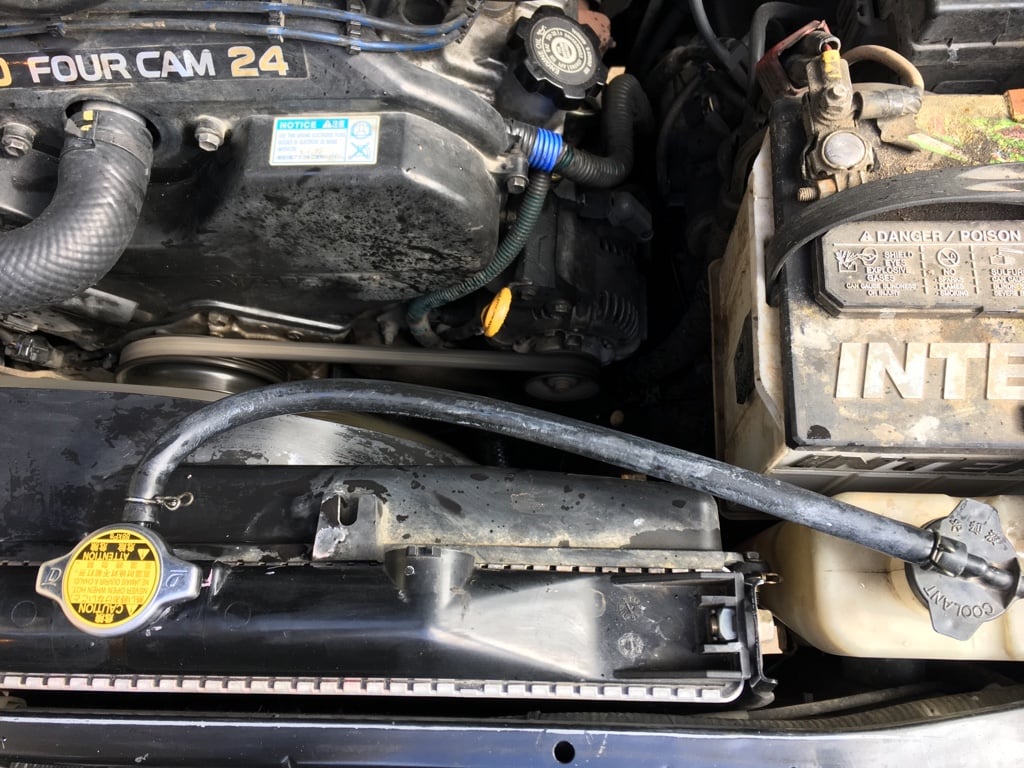

Checked the overflow hose and it's totally clear. The one thing I'm wondering is if the silicone tube was too short and maybe it's causing a kink? Picture here.
I'm going to let it run for a bit and see how it all does. I really wanted to take it off-roading tomorrow on my way to a climb but not super confident now.

When I put the new hose clamp on in the same spot as the old indents, I noticed that the bottom side of the clamp was crooked and not clamping the bottom of the hose.
Maybe that was it the whole time? I mean, wouldn't an improper seal on the hose clamp allow air in (suction to make the hose flat when turned off) and a coolant out when the system was put back under pressure?
