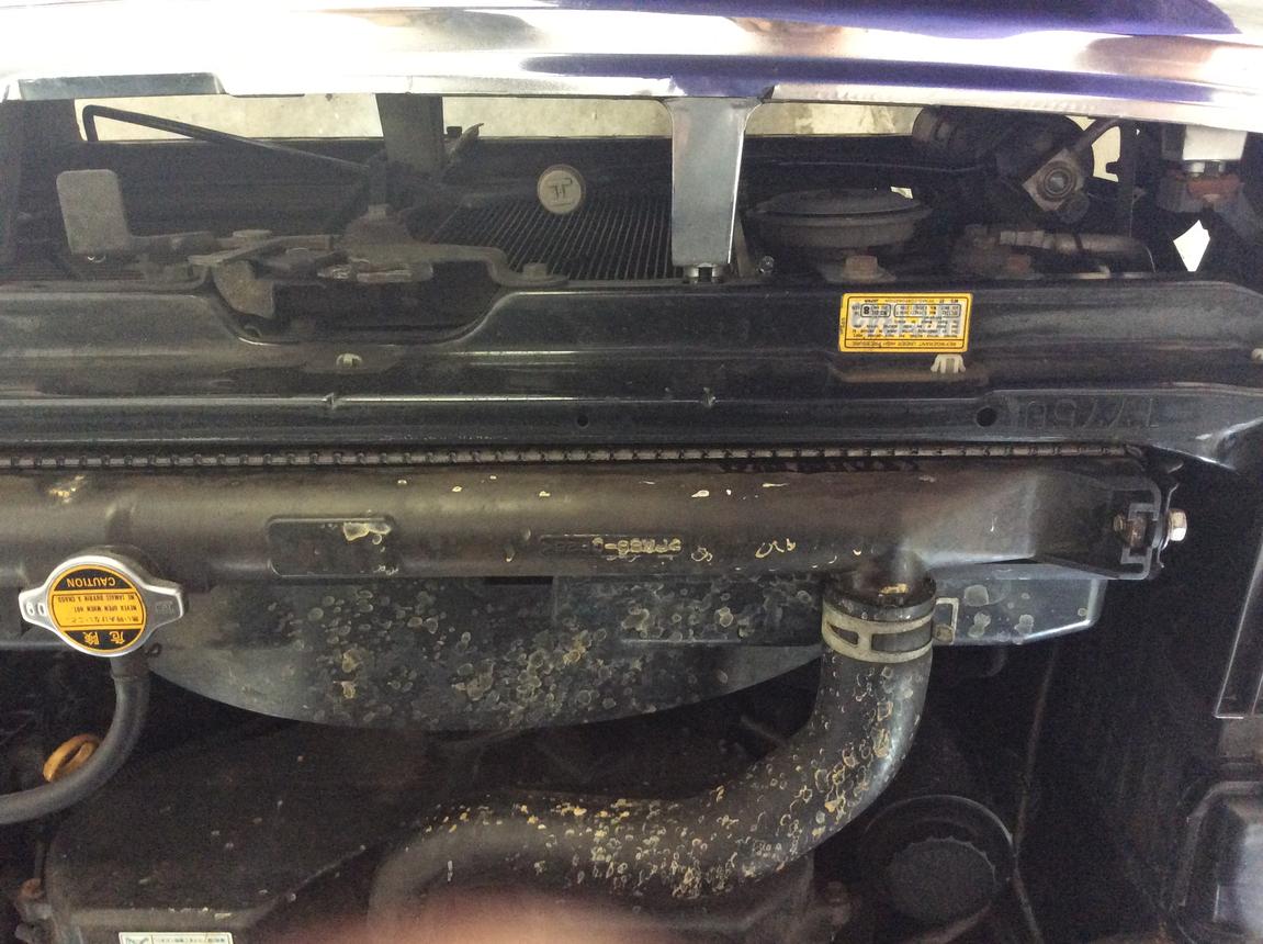

My radiator has been spitting fluid recently. It has been extremely hot in SE NC and seems to happen on days i dont even use it. I recently did the trans cooler, so thought it was leaking from the bottom where i disconnected the trans hoses and avoided a pink milkshake. However the hoses are secured tightly where i put them (i connected the two just in case it wanted to bust i wouldn lose all he coolant). So i havent driven in a week, just to see what would happen, and the refilled colant is now gone, but theres not a huge spill under the car. The garage smells lke a cat pissed everywhere though, so it is escaping to somewhere, possibly just coating everything underneath and evaporating, since it isnt even pooled up in the skid plate. Ill include pic of it in action, where you can see water (ill drain it all later when i figure out where its leaking, just to avoid the expense and smell of coolant) seeming to pool up on the top front portion of the radiator, just below the plastic section. Other than that, i cant seem to find any leaks. Anyone care to comment on what could be happening?

Looks like it is coming from the top radiator hose when the system is pressurized.
How long has that coolant been in there? Might be time to flush the system, change both radiator hoses, and refill with Toyota coolant.
That's what mine looked like before I replaced the radiator. The top seam had a small leak and the fan threw coolant all over the place.

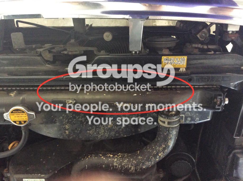

Your top tank split in the same exact location as mine. You can see it in the picture you posted. I'll edit this post with a link to mine as well as a circle on the pic you posted to indicate where you can see it.
Edit 1: http://www.toyota-4runner.org/3rd-gen-t4rs/222674-top-radiator-tank-split.html
Edit 2:
split_zpsublrubor.jpg~original
Thats exactly where it is coming from. I squeezed the top tube a few times and the fluid leaked out of that spot every time. Is this a common thing and can it be replaced or is this a new radiator situation?
New radiator. They are like a hundred doll hairs. Go oem from dallas totota or camelback toyota.

I can't say it is common but it happened to me and at least three other people between here and yotatech. So maybe there's something to it?
But I digress, to answer your question: I can't recommend attempting to fix it unless you run a radiator shop and know how to replace only the tanks. Best bet is to get a replacement (some have had very short term luck w/JB weld but I do not recommend it).
