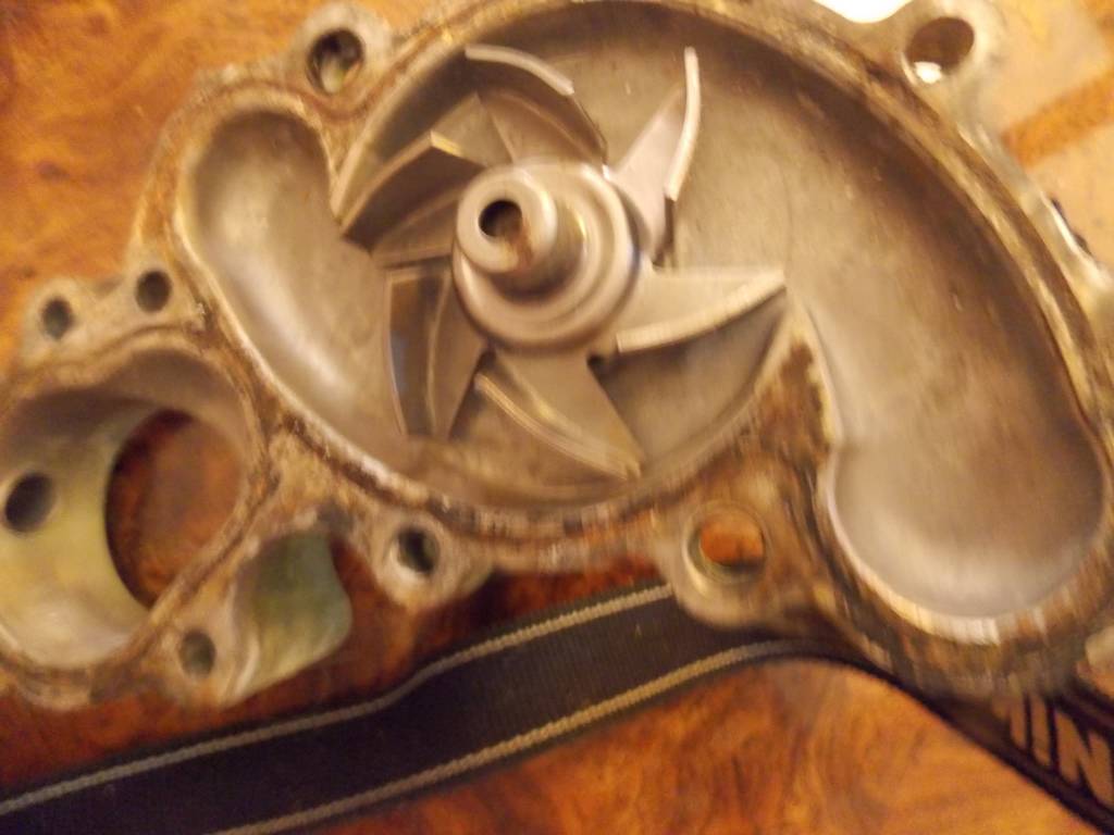

Well, then the TSB is total BS. A change interval of 15k means the anti-corrosion package is essentially neutralized. I'm not arguing with you; it never made sense to me anyway. Even though I have run 60k with no problem, I think the 40k is a better number at the age of our trucks. Here is a pic of the inside of my factory water pump that I pulled after 120K with just the one change at 60k always Toyota Red. Absolutely no sign of corrosion on the wet parts. The crud on the impeller is center is just crud from the spare box. From what I could see at the time, the inside of the passage was even better. The WP has also been exposed to air in my trail spare box for two years so its no longer shiny.

Oh yes, you're totally right about the 50k.
