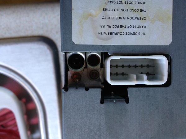

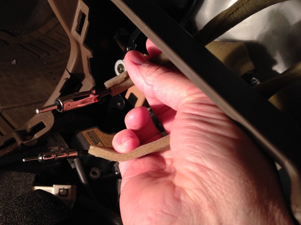

Hey guys,
I am installing an aftermarket stereo in my 2000 SR5. I just pulled the factory stereo and have a question about the connections. There are two antenna type plugs on the factory stereo, a large and small one. My new aftermarket stereo has the larger hole but not the smaller one. Can anyone tell me the function of the small plug? Here are a couple of pics. Thanks.

It's the other antenna that is built into the back glass. You don't need it with your new stereo. The OEM one would switch between the fender mounted one and the rear one to find which ever had greater signal. Some people use adapters and a Y-cable to get the two antennas into one plug so it can go into the new stereo. I chose not to do this and only run the fender mounted one and it works great.

I've heard mixed reviews. At a minimum, understand that RF engineering is a lot more complicated than "now connected in parallel therefore better signal reception". It may actually degrade the signal reception.

Yeah this was my reasoning for just going with the fender mounted one. The OEM radio would actually switch between the two antennas, whereas plugging them both into the same jack could cause some sort of issues. So far with only my Taco whip antenna I have great reception. I can pick up radio stations from Birmingham and that's about 100 miles south of me.
