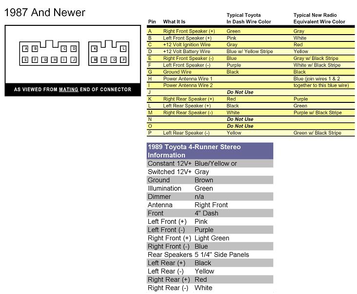

All my wires are connected (I've checked and double-checked).
I have power in the plug that goes in the radio. I have 12 Volts which I checked with my multimeter.
However, I noticed that I have 12 Volts between the C & G plugs (+12 Volt Ignition Wire & Ground) BUT I don't have anything between the D & G plugs (12 Volt Battery Wire & Ground). See pic.
Should I have juice between the last two ? If so, that should be a fuse, right ?
Else, .... wtf :confused:

Don't have wiring schematic handy - that "D" termial is constant voltage for the radio's preset button memory. So even if no voltage there the radio should come on from the ignition battery connection- you'd just have to scan for a local channel. I heard where on some years, owner will plug in a high draw item like a laptop into the cigarette lighter and next thing they know their radio and/or clock no longer work! In that case there isn't a visible fuse --- instead its a hidden inline fuse link just behind the hot wire plug in to the cigarette lighter. Can't see how it would affect vehicle starting though. Does engine not even turn over - or turn over (starter grind) but not start up. Checking all fuses, reseating them and the little relay boxes is good start. Some fuses can look good but doing a continuity/resistance check with your meter reveals blown fuse.
