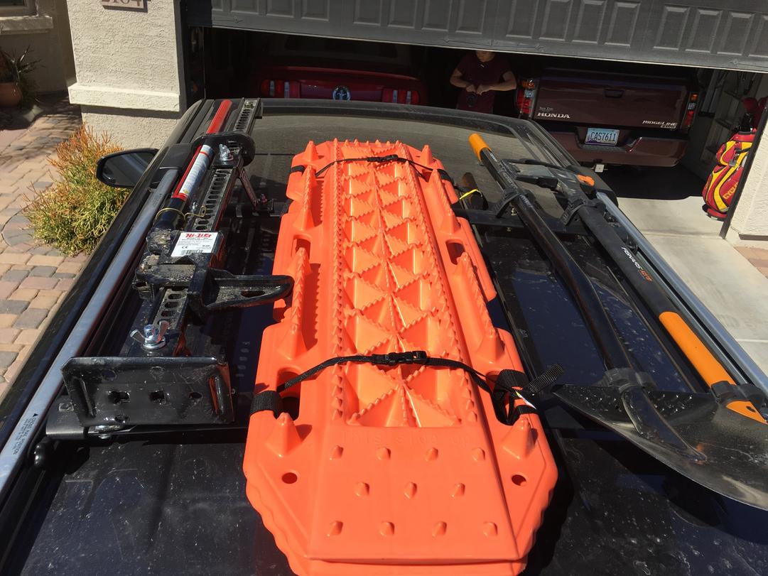

One of my prototype sets:

From the research I've put in developing mine, the factory rails are strong enough to hold a few hundred pounds. I've got a hi-lift, tool box and tools, and maxtrax on my bars, and I also stood on it at the same time, and saw no bending. Tents *should* be OK up there, but they're definitely not as strong as replacement rails. I was actually going to do a load test to see what the breaking point is of the factory rails next week.

Huh, so I'm not the only one working on developing something like this after all. Interesting to see another take on the idea.
