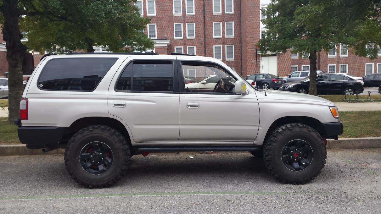

Personally, I have the 890s in the rear and almost new 99 springs up front and I really like the 2" of rake.
Thanks. I really like that stance. But my tires are stock and I spend most of my time on the street. Would that setup look odd with smaller tires?
You Sir, are correct..... that does look good.
Your truck is pretty sharp!

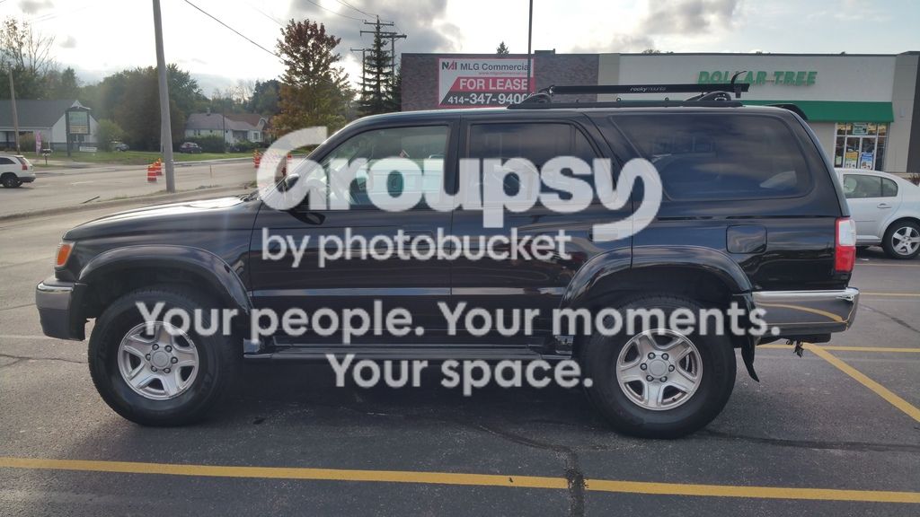

906 springs in the rear for sure. I've had them two years now, and the rake is still perfect.
One day, a stock suspension 4runner was parked next to me in this same lot, and looked positively saggy in comparison.
Thank you!
And btw, I have 34" tires, so it does make my truck look lower than it really is :lol:
