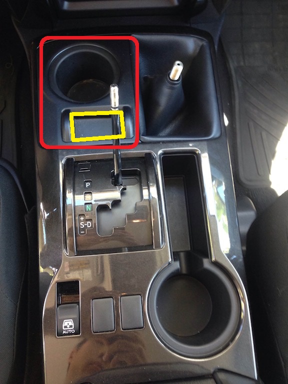

I am wanting to install a Ram mount to my console for phone/tablet use. I am considering between the cup holder and a mounted option.
For the mounted option I was thinking about a mount with a backing plate in the yellow area below.
As part of my consideration I would like to see if it's possible and or how expensive it would be to replace this plastic piece for later re-sale or if I change my mind. The plastic piece I am wanting to source is outlined in red.
Thanks much! Steve.
NB I stole the picture from another 4runner.org user

Yeah, I have been trying to figure out something to do with that stupid coin tray... I'm thinking switches, but a phone mount would be awesome.

That setup will work for a phone but a tablet will vibrate and move a lot as the plastic assembly will likely flex with the heavier weight
I got a diamond base for that random coin holder spot...it fits almost perfectly, only needs to be filed down a bit to fit. For the most part I don’t have any issues with the phone being there, only on the worst of roads will the cup holder dislodge. 99% of the time it works great.

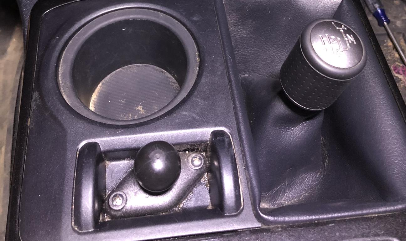

RamMount also has stud and nut only balls (man, is that ever a lob pitch for the peanut gallery...). Back those with a fender washer or fabbed up plate on the backside and you can get a cleaner look.

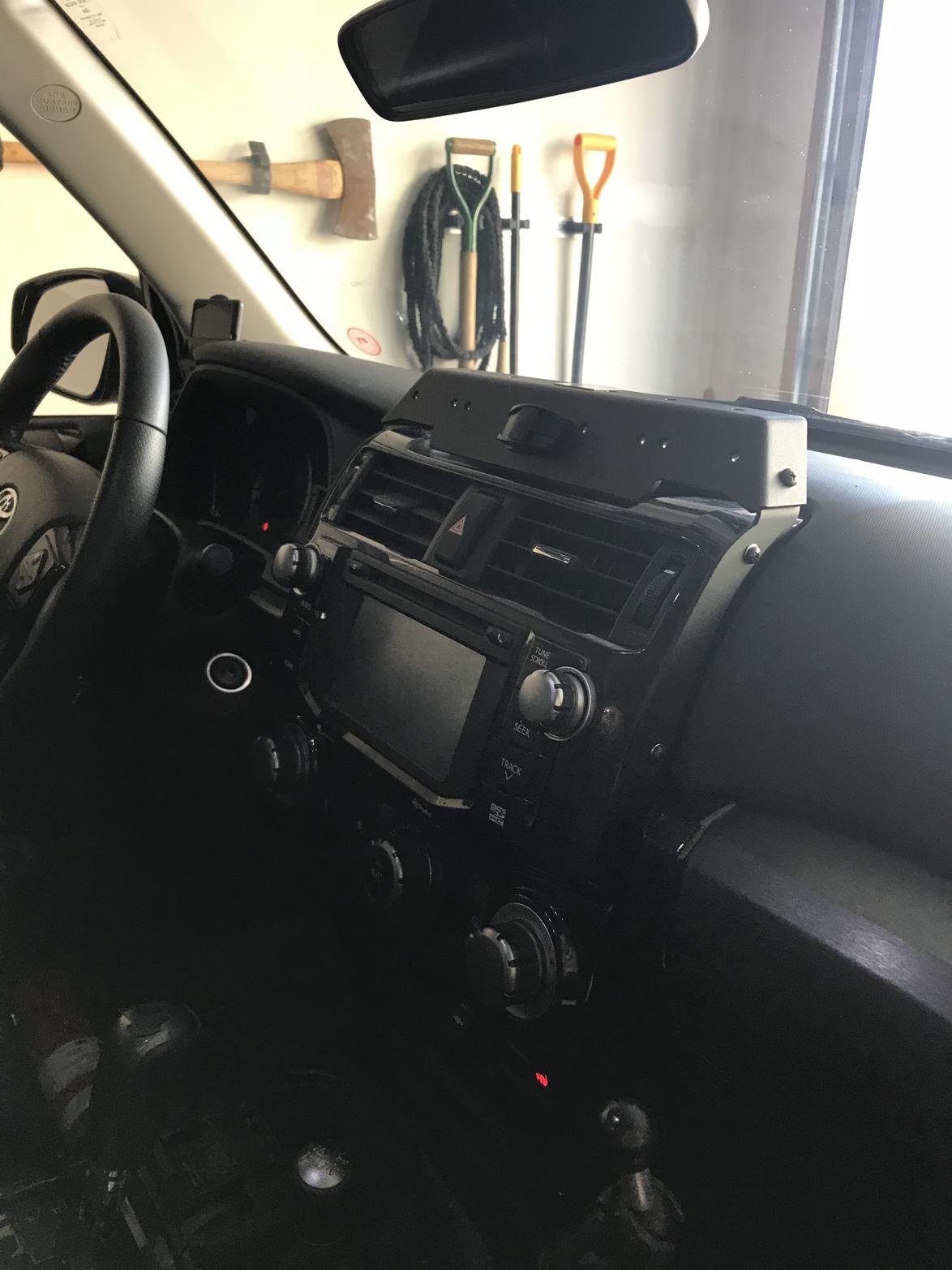

I picked up the Expedition Essentials mount and good golly it is well made. Very solid mount and the added USB plugs is just what I needed.
I doubt this mount will break!

I wanted to like the EE mount, but I just don't think the execution is there.
I've been running this setup for about a year, and it's survived some pretty nutty thrashing off road:
I know some won't care, but blocking the clock to me is just not a good design choice, it's also really tall, and I'd rather not have to put that many holes in a trim piece. Mine just uses RAM 1" balls and some hardware to make it all lock together.
If I could redesign the EE one, I'd make it a LOT lower profile, have it dip down to reveal the clock, and use aluminum like they already do, but opt to use steel helicoils (as much as I tend to hate them on our camera gear) that way you don't need to put a nut under the plate. Make them 1/4x20 like almost all camera gear is. That way you can make the rear enclosed. Having the back end open, visible from the front of the car, just looks less than great.
my issue with the EE mount or anything else in that location is you have to make the decision of blocking off your center vents or majorly impacting your visibility
i use a proclip on the center console for my phone and a ram mount with x-grip from the center console for my tablet
Do you not have issues with the console plastic flexing from the weight of the device at the end of the arm? I guess my real question is: Did you reinforce the ramball mount underneath?
There's vertical plastic ribs under that plastic by default, they make that plastic a lot more rigid than you'd think. The trick is drilling the hole so that the nylock nut sits between the ridges/fins.
