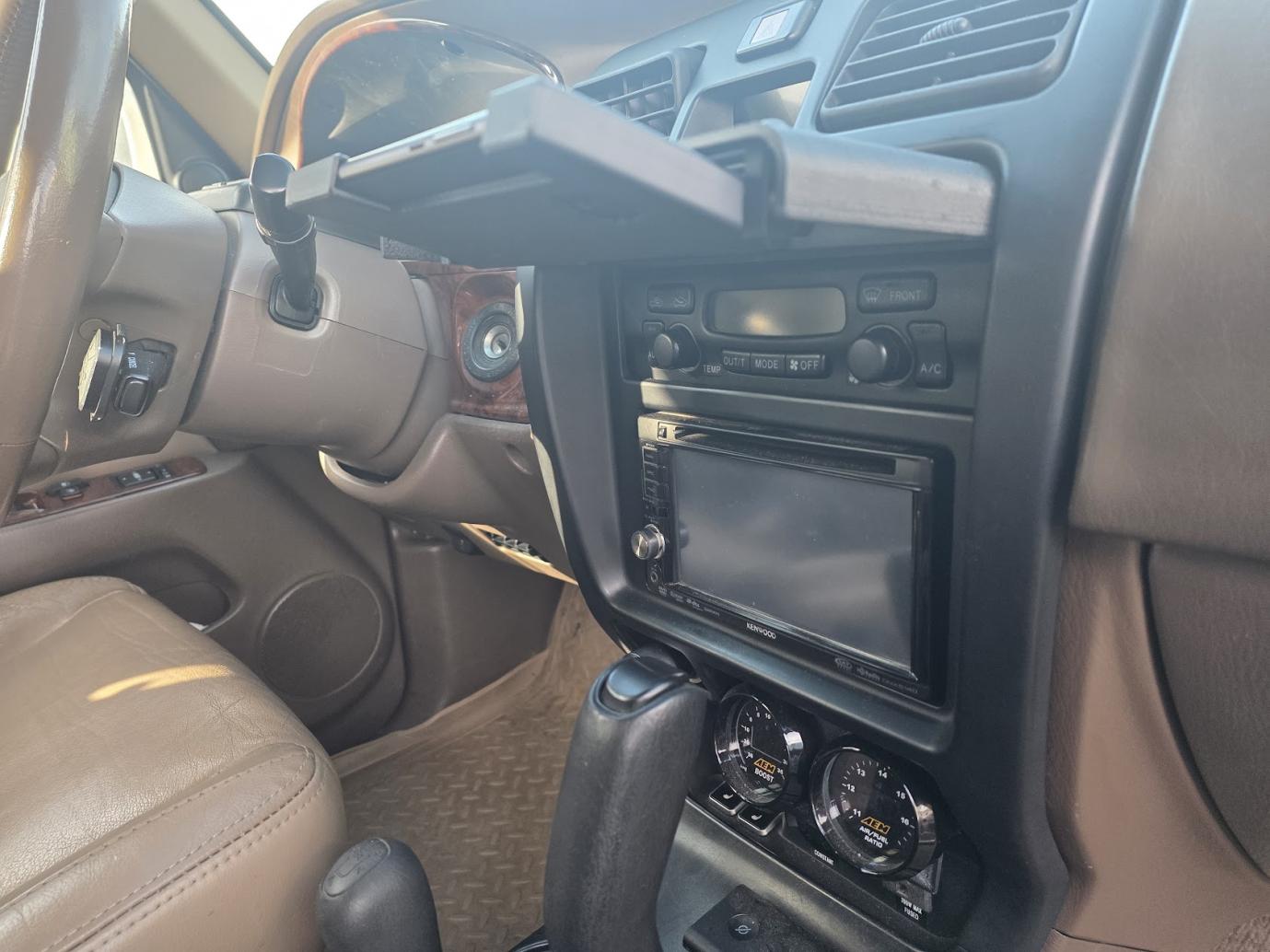

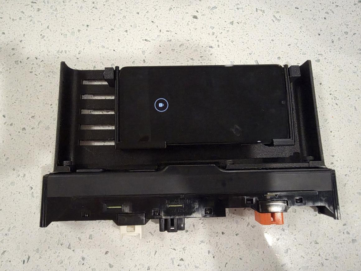

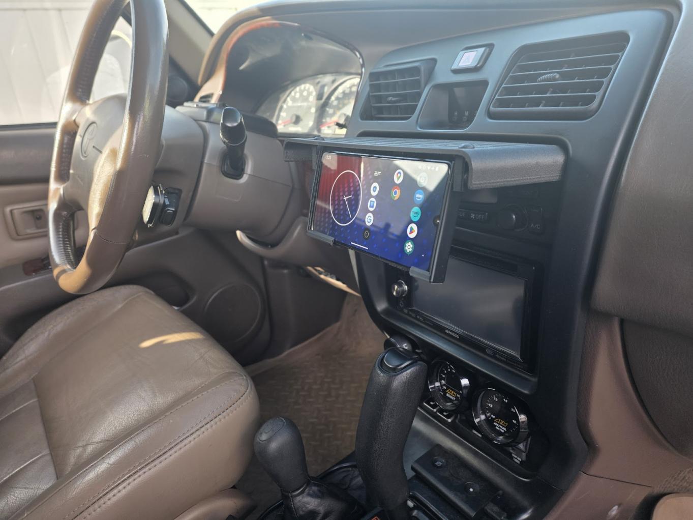

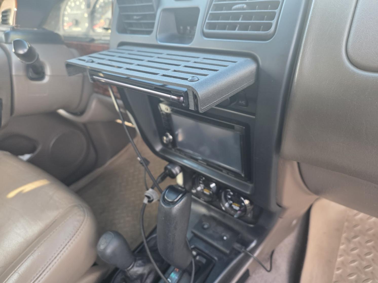

After looking at some options to mount a spare phone that I use exclusively for control and monitoring of my overland build (Ecoflow, Fridge, onX, etc), I didn't like what was out there. Because this phone stays in the truck, I wanted it easily accessible, but not viewable.
I came across a mount that gets bolted to the center console, but I didn't like how you had to drill into the console which aren't cheap to replace.

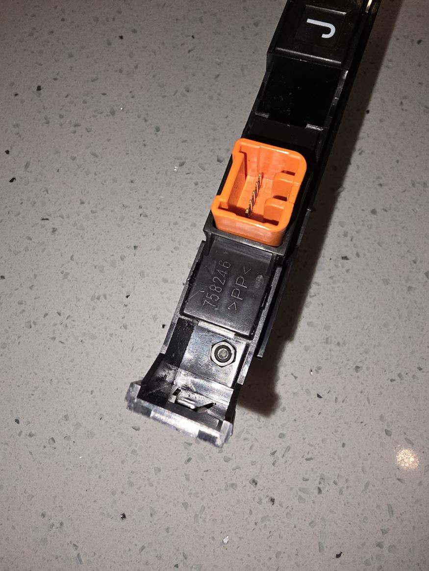

I decided to build one from scratch which integrates into the switch panel using bolts and nuts. The switch panels for 99-02 are significantly cheaper than the center console (should I ever need to replace it) and it just inserts from behind the console as one unit. Also all the buttons are easily accessible regardless of the position of the phone.
This makes it super secure, doesn't rattle, can't move, etc. Then I customized a mount for my phone that swings 180 so I can hide it when not in use. I can also easily slide the phone out if I need to hold it. And since I built it with "rails," I have the option to use it to mount other things as needed (might move my scangauge or even install CB, or use the upper part for my regular phone, etc). It really helps add some real estate for mounting options.
Used a mix of ABS filament and PA6 Filament for added strength and heat resistance.
