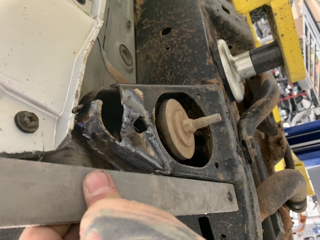

I just went to 285/75/16 on my 04. I wanted the wildpeaks but at $300 a tire I just couldn’t do it this time so I went with the General Grabber AT/X. I have the Toytec ultimate 3” lift and total chaos UCA’s. And I believe my wheels came off of a ‘14 Tacoma TRD pro. I didn’t have to trim any bumpers or move any plastics forward. But I did have to trim plastics on both front fenders towards the door near the body mounts. We also drove it into a big ditch and noticed at full compression at full lock both sides were slightly rubbing the body mounts. So I cut a small chunk out of the body mount trimmed it up flipped it around and welded it back into place. That gave me about another inch of clearance and no more rubbing for me.
