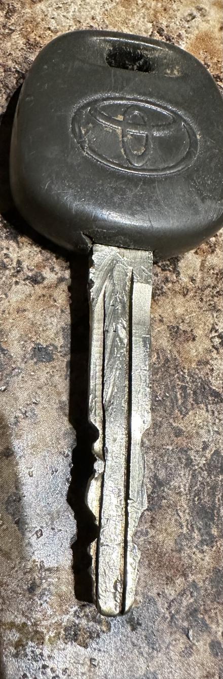

Yep, unfortunately my only key for my 07 fell out of my pocket while mowing grass and I ran over…with the blades on.
Good news is I was able to find the key, although it was twisted like a pretzel. Also found the rubber piece that fits on the end of the key. The lock fob did not survive. It’s in pieces.
I tried my best to carefully straighten out the mangled key, but to no avail. It will go into the ignition and I hear the beep, but it won’t turn.
Basically at this point, what are my options. I have no spare and no working key. Maybe the transponder is still good….hopefully it’s in the rubber piece and not the fob. I’ll post a picture of the key after I tried fixing it. Please let me know if it might could be fixed by a locksmith.

Good to hear from ya AuSeeker! The transponder chip seems to be working. Wondering if a locksmith could cut a new key and just transfer it to the existing transponder.

Thanks! Glad to hear you got it sorted out relatively easily. Looks like my chip is still good, just the physical key is damaged. Gonna call a locksmith tomorrow and hopefully they can just cut a new key and pair with existing transponder.
