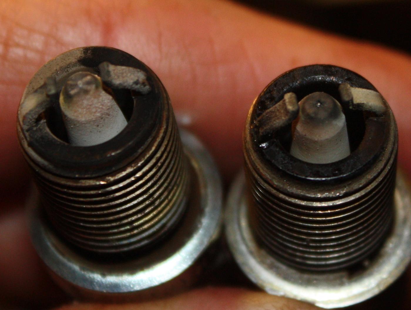

6 looked fairly normal but did not have a white (X) across the center of the ceramic like the others did. It looked like it had a little black dot in the center instead. Also, there was a mark on the plug boot right above where it covered the plug that look funny, like it might have been arching. Plugs are Bosch Platnum +2s. I happened to have 3 others that i replaced 1,3 and 5 with.

I really wanted to know about the electrode end on #3 and #6. Color, wet or dry?
Well I am somewhat color blind but on 6 the center was darker and the metal ring around the outside was a shiny black almost wet. I will try to get this pic up the one on the right is 6.

New plugs and new wires. Those have plugs have been in there a while. Again, what kind of new plugs did you put in? On the wires, I recommend either the Densos from the dealer or the NGK TE-66 set from Amazon, NAPA, sparkplugs.com or wherever. I am guessing you have factory Sumitomo's with 1999 written on the wires?
No, i replaced them in 08 along with the bosch plugs. I am sure they are from Autozone but dont remember the brand.
