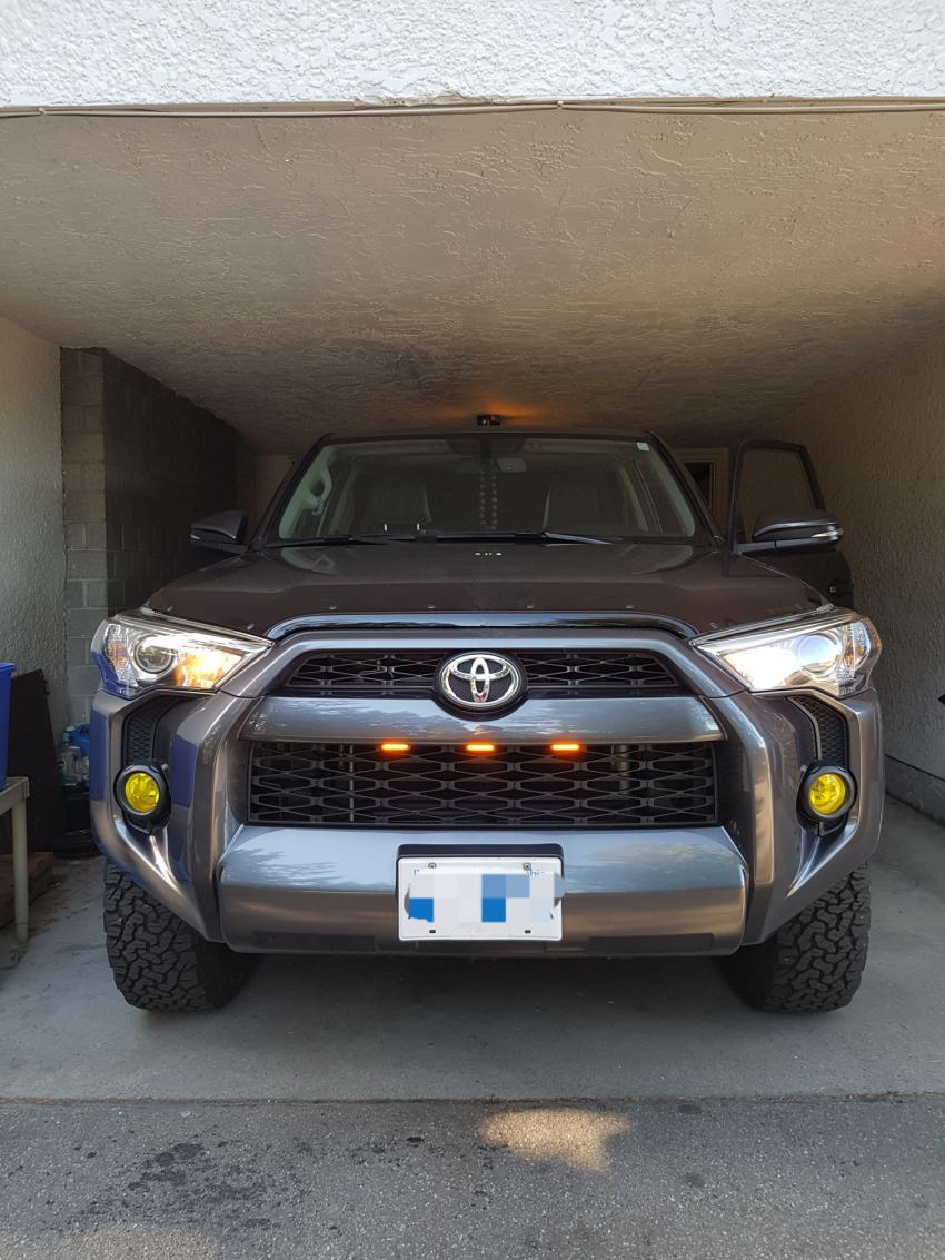

Here is what I did with mine. It is double sided tape underneath the horizontal piece.

I've been trying to find pictures of anyone that's installed raptor lights on the 2020 without a Pro grille. The top grille doesn't have the same diamond cut outs due to the silver bars, and the TSS is in the middle on the lower grille.
I'm playing around with placement, what are your guy's thoughts? Has anyone else mounted them around the TSS and can share a pic? Any option besides buy a Pro grille at the moment is open.
